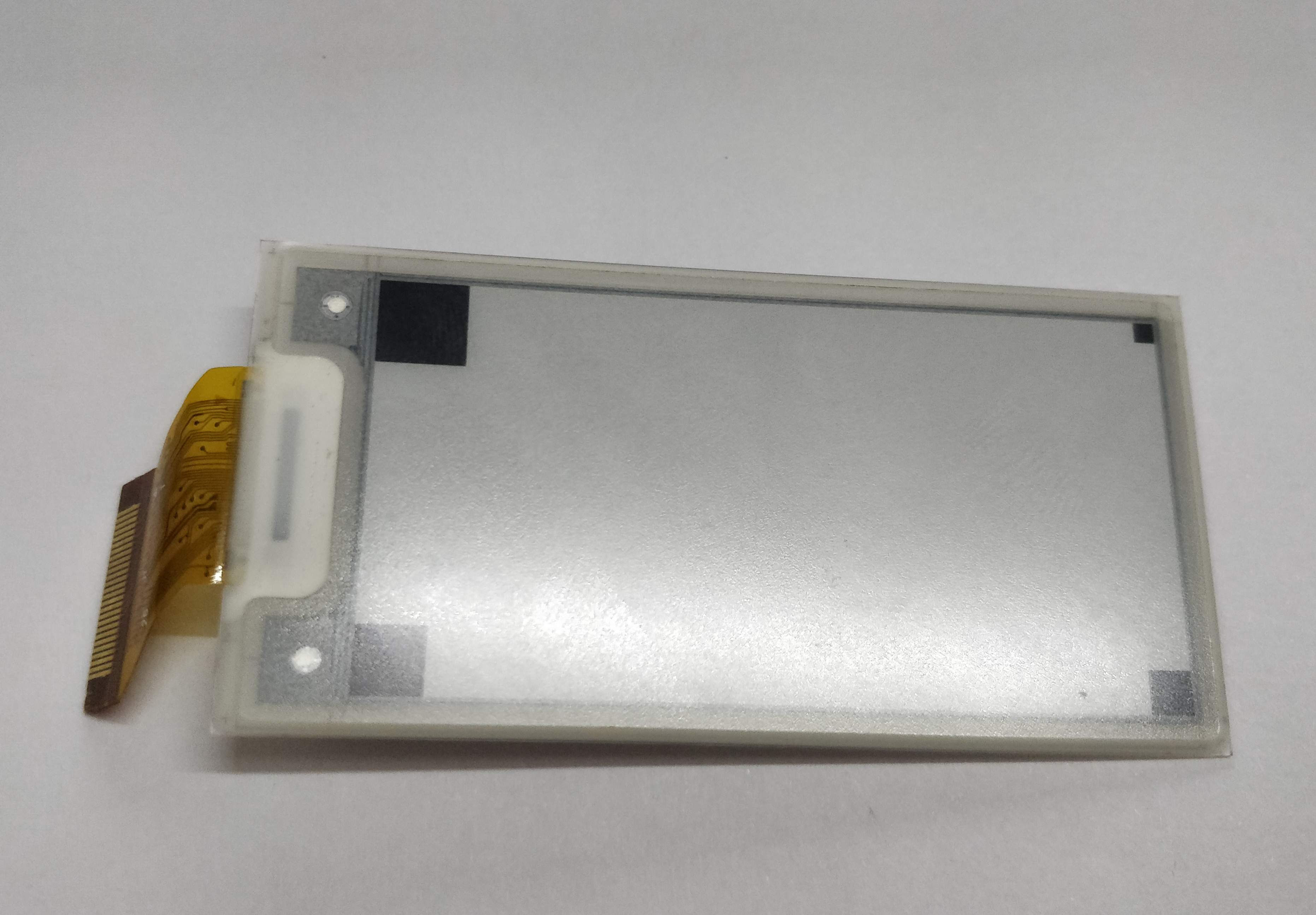

about it yet. I bought a few 2.66 ink screens from Lao Wang, and the effect is quite good. I thought the resolution was not much higher than 2.13, because no one here is using it, and they are all 2.9-inch models. , check the results. . . The resolution is actually higher than the 2.9-inch one. The horizontal resolution is the same. If the vertical resolution is larger,
then I’ll make an ink screen driver board. I’ve been using a lot of 8266s recently, so I just made the 8266. Check whether the glycyrrhizic acid is sour or not on the platform [New UI] The 2.9-inch SD ink screen reader is good, so let’s change it. .
As a result, it was imported by kicad. . Then just redraw it
and leave it at that,
removing the front light, because I can’t afford one with a front light, and it won’t fit on the board,
so I might have to change it. . Prepared to use his original shell, the result. . The case of the one I bought is missing, and the new one has not arrived yet.
Let me share the information about Lao Wang’s screen (there is nothing to share). The one I bought is a bw one, which is the same as the 1.54 Lung Hot one from a long, long time ago. bwr is a manufacturer, the cable is also 34p, there are 5 useless pins on each side, the driver is the same, it is UC8151C, that gxepd2 can drive it, use the 2.6-inch screen from Jiaxian
