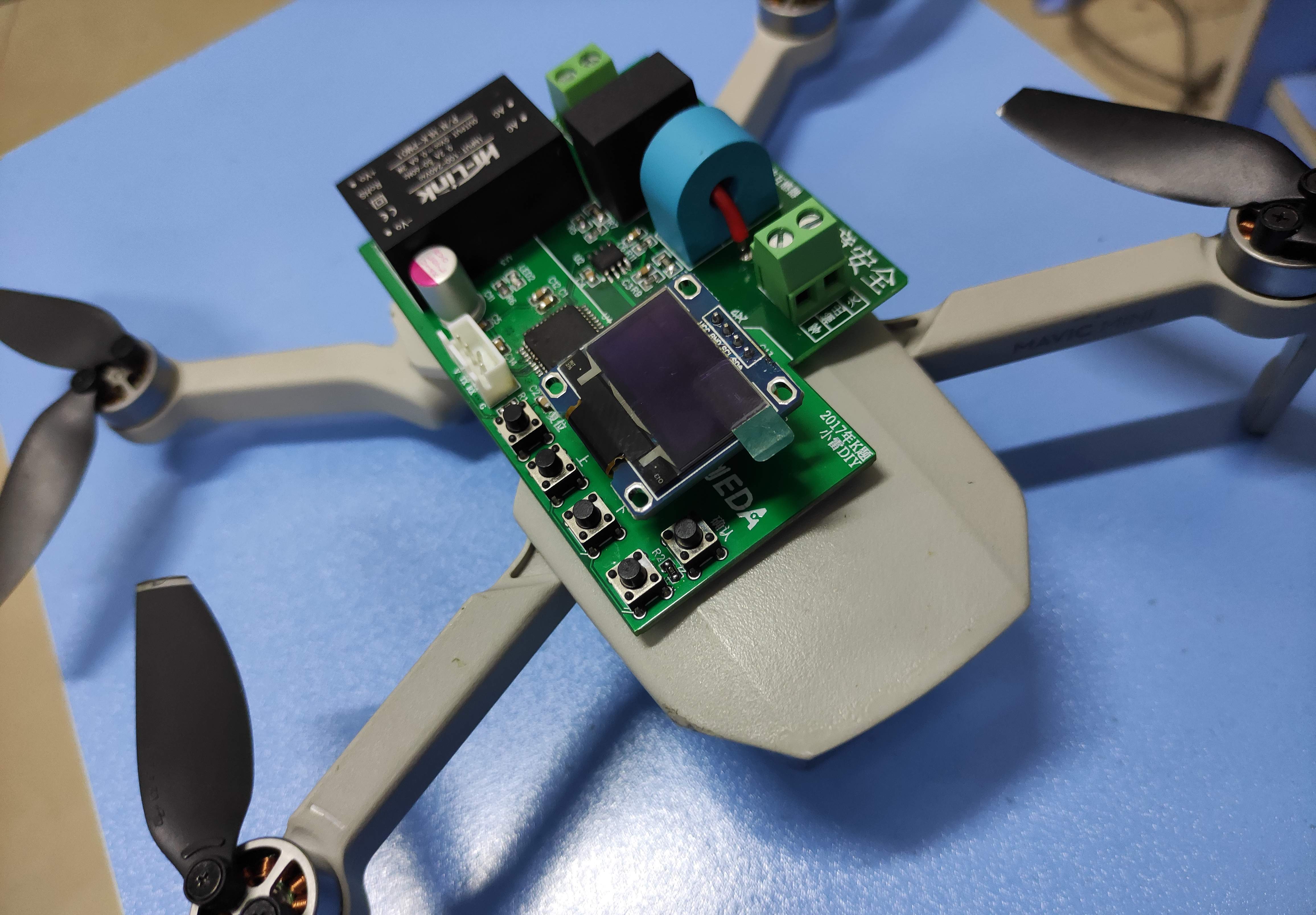

The picture above shows the PCB board I designed. It has a simple structure. The upper part is the high-voltage part and the lower part is the microcontroller processing part . What we should note here is that the 220V AC power must be provided with slots to prevent electricity creepage.
The way to set the slot is to draw a top line of about 20mil, then right-click and set it to slot
Before designing the PCB of the power supply, we need to understand two things first. The first is that the power supply circuit generally has a large current. Generally, the copper coating on the PCB is 1OZ.
When we design the connection line, it is best to wire it according to the 100mil 5A standard. My power supply is 2-3A.
So I chose 80mil power supply wiring, and the current must first pass through the capacitor and then enter the component, which can greatly improve the efficiency of our circuit. This time I chose semi-circular arc wiring, which is more beautiful!
It is best to leave a little space between each module, which is not only more beautiful but also anti-interference.
Add via holes and large areas of copper to increase current and increase heat dissipation
The picture above shows the 3D model of the circuit board

The picture above shows the working power. Only 0.856W meets the requirements of our question.
