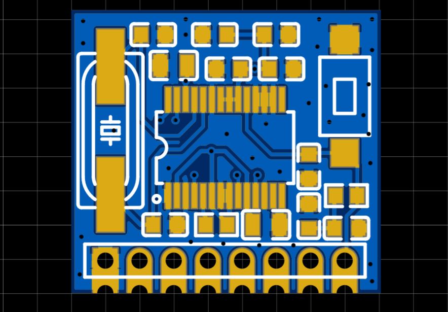

* This design is a Speech synthesis module module based on SYN6288.
* SYN6288 is a widely used and low-cost speech synthesis chip
* The circuit designed includes the SYN6288 chip and necessary peripheral circuits. The input voltage of the circuit is 3-5v. The output BN and BP can directly drive the micro-speaker and be used in the array. On the basis of the pin interface, stamp hole SMT pads are added to facilitate rapid integration into other development boards
* The next step will be PCB board proofing, and then the PCB blank board photos, soldering finished product photos, and program testing will be updated

updated proofing was back on 2020/3/2
(actually it has been done for a long time, but I was busy with online classes and did not have time to send it out). Then I took out the components and
prepared the components for welding and the empty board:
![IMG_20200217_110258.jpg] Tin one of the pads of the chip component with a blank board
![IMG_20200217_110804.jpg] Solder the components except the main chip
![IMG_20200217_112059.jpg] Finally solder them (please ignore the flux and too much Too much tin, due to the epidemic, the solder paste I bought did not arrive.)
![IMG_20200217_112706.jpg]
Then, power on, connect the serial port, and send. . . It didn't make any sound. . .
All the components were measured and there were no problems. The noise floor of the power amplifier inside the module could also be heard from the speakers.
So I checked the datasheet and found that the input needs to be connected to an inverter. . .
Put three components on it, power it on, and it's finally ready to use
. Here's what it looks like in the end. . .
![IMG_20200302_110327.jpg] However, the above schematic diagram has been updated and can be used directly.
