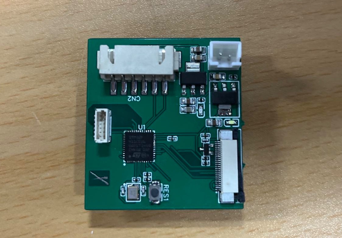

smallembedded
Integrated board
Graduation ProjectVision_Stand
page editingAPP
interface
settingspageControl
picture displays the current camera positionpageRememberEx
different
object position
memorypageRollEx
bottom turntable rotation
can set speedpageOtherbrightness
settingsomething
wanna to say to this universityAbout
saving settingsOriginally planned to use keyboard components, but the control area is too small to be applicable, so use BTN button to save directlySITE1~4
stepper motor controlPA11
(zStep)_PA12(zDir)
PA8(xStep)_PB15(xDdir)
==The joystick control is controlled according to the size of the screen==
