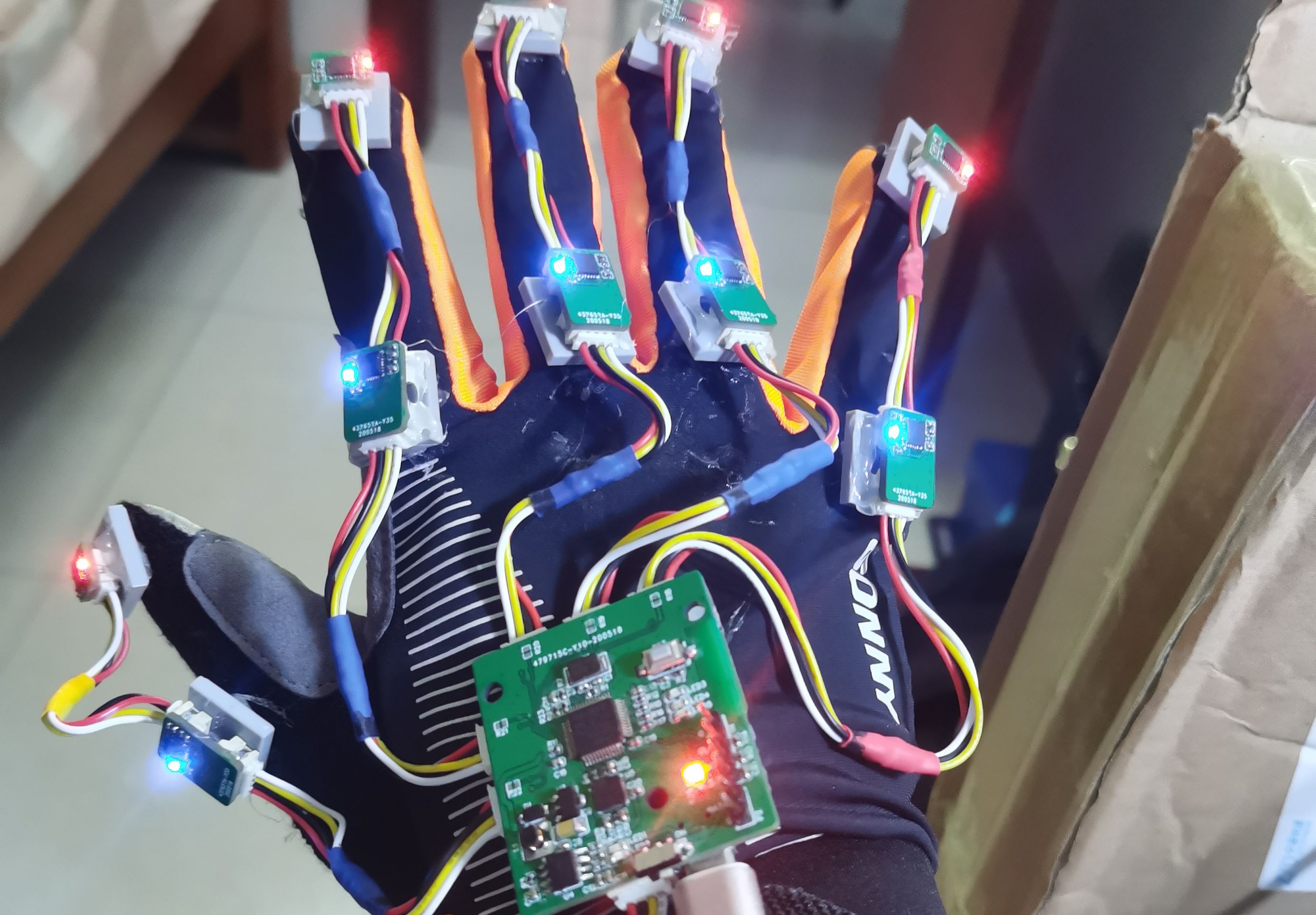

Two MPU6050s are arranged on each finger, one is arranged on the palm, and one is arranged on the forearm. A total of twelve MPU6050s are used.
Euler angles in 12 sets of world coordinates can be obtained from these sensors. In the program designed by the host computer, the end knuckle will rotate as a whole by following the previous knuckle, and then rotate relative to the previous knuckle. Therefore, it is necessary to convert the Euler angle in world coordinates into the relative rotation angle between the knuckles before transmitting it to the host computer.

The final test results are: the upper function can recognize the movement of two joints on the five fingers of the glove, as well as the movement of the forearm and palm in space, with a static calibration function. The gloves transmit data wirelessly and have power management to charge and discharge.
The following are circuit and actual pictures:
