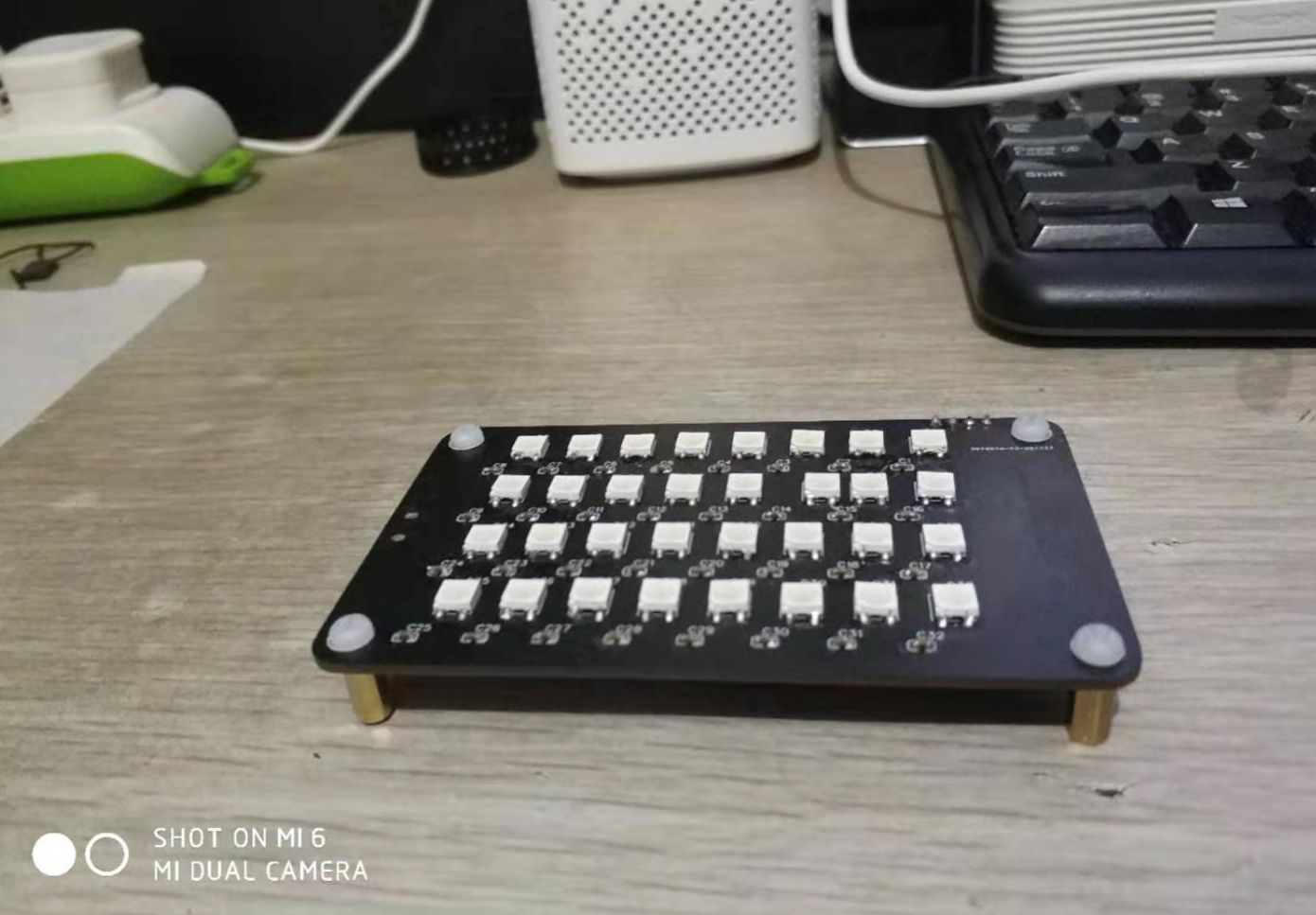

Tuya WB3S solution colorful lights
The main control uses Tuya smart WB3S module, USB power supply, two-stage toggle switch, and uses AMS1117 3.3  linear voltage regulator (LDO)  to step down to 3.3V to power the module. LED1 is the Red power indicator light. IR + - is an external infrared receiving module. You can weld the header to insert the module, or you can directly weld the infrared receiving module. Optional operation (you can use it if you have it) (note that you need to set the firmware on the Tuya platform according to the remote control Set the remote control key value) There are three 5050 RGB common anode lamp beads reserved on the back of the circuit board for the convenience of single board use. RGB 5V is a pin header for external light strips. It can be straight or curved. It can be connected to an external light strip or a separate light board can be used to cascade to extend (increase) RGB lights. 002.jpgWeChat picture_20201126140408.jpg
ESP8266 colorful light solution
Based on the ESP-12S to control the WS2812B colorful lights, connect to Xiao Ai through the lighting blinker, and can be controlled by the APP and Xiao Ai's voice! ESP-12S GPIO13 controls WS2812B RGB lights, which can realize APP and Xiaoai voice control of colorful light switches, color adjustment, timer switch, and display mode switching. WeChat picture_20201206001311.jpgWeChat picture_20201206001307.jpgWeChat picture_20201206001316.jpgWeChat picture_20201206001325.jpgWeChat picture_20201206002904.jpg
Example code
Write a program through Arduino, connect to Lighting Technology, and connect with Xiaoai classmates!
/*代码源于网络,源地址找不到了,进行了二次修改,采用SMARTCONFIG进行配网:
* 灯光效果目前的循环模式是,每循环一次效果检测一下blinker的新命令,所以会有blinker app按键不能及时同步的情况,同样语音助手也
* 可能迟钝。blinker有频次限制暂时做不到随时中断灯效下的循环。
* 这次的代码新增了fastled示例中的cylon,同时也有之前adafruit_nexopixel中的示例。大家可以看自己的喜好添加效果。
* 具体的流程:blinker app设置控件--关联智能家具--编译、上传代码到开发板  相关教程参考电灯科技的官方开发文档与教程,也欢迎交流。
* 预设五种模式+调色盘 除按键1外,默认都是先用调色盘调亮度物种模式才能正常显示。大家可以更改预设哈。
