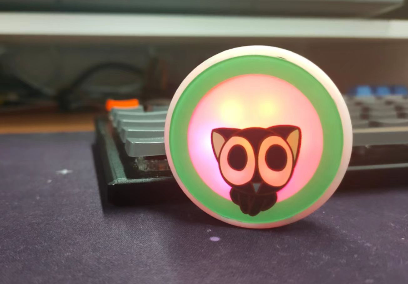

Since the colorful badges produced in the previous version require an external driver and are not easy to carry, this portable colorful badge powered by a button battery is designed for daily play.
Compared with the previous version, it has the following advantages:
(1) With its own driver chip, the badge has good integrity
(2) Powered by a button battery, low power consumption in the off state
(3) Supports display mode and brightness adjustment, and supports mode switching
(4) Designed magnetic structure for easy assembly
(5) Drawing on the PP coin gameplay, it has playability and good operating feel
2022.12.14 version improvement instructions
① Replace the solution of contacting the conductive sticker with the PCB to produce a button effect with a two-way switch to make the top cover rotation effect more controllable;
② Modify the structure of the top cover and use 3D printing instead of the effect of the uniform light paper;
③ Reduce the size of the lamp beads and increase the number of lamp beads to make the display more delicate.

5. Instructions for use
5.1 Color switching and brightness adjustment
Rotate the top cover in the light adjustment mode to adjust the light color;
rotate the top cover in the brightness adjustment mode to adjust the light brightness.
5.2 Mode Switching:
Flip the bottom cover and short press the back button to switch between light adjustment mode and brightness adjustment mode.
5.3 Power On
/Off Status: Flip the bottom cover and long press the back button in the power-on state to shut down the badge. The microcontroller is in a low power state and the power supply of the lamp beads is disconnected through the MOS tube. In the power-off state, flip the bottom cover and press the back button to automatically enter the power-on light adjustment mode and retain the previous color display and brightness configuration.
