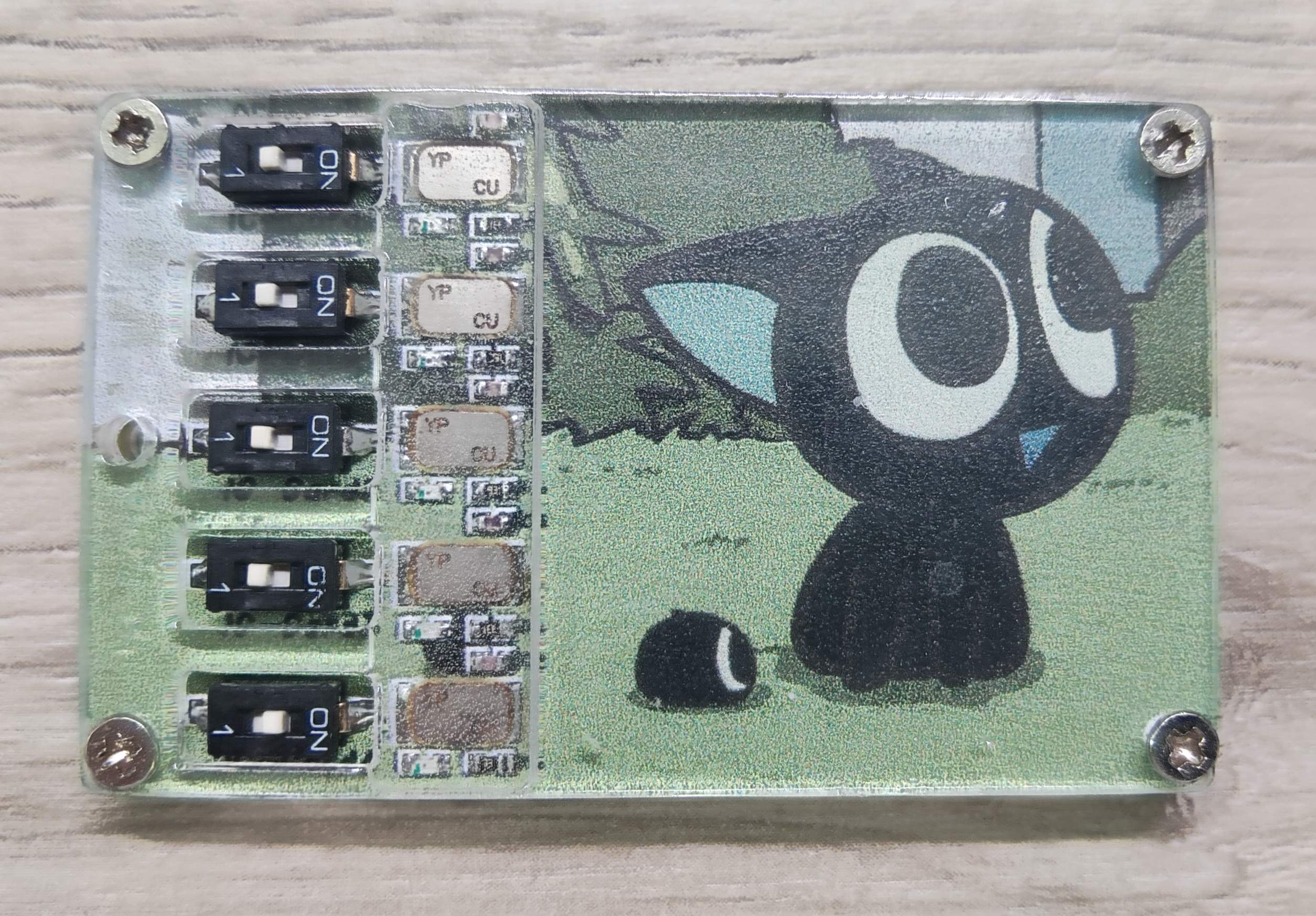

## 1. Circuit design
The operating frequency of the IC card is 13.56Mhz. The PCB can be obtained through ST’s official [NFC inductance calculation tool] (https://eds.st.com/antenna/#/) The inductance value of the coil is 6.02uH. The cuid capacitor value is 20pF, C = 23pF, and the TBD capacitor can be 3pF.
![QQ screenshot 20230719202529.png]
## 2. Use of IC card
### 2.1 Copying the IC card
reader I used the PN532 module and connected it to the computer using a USB to serial port.
- Ordinary IC card: Sector 0 cannot be modified, other sectors can be erased and written repeatedly
- UID card: Ordinary copy card, all sectors can be erased and written repeatedly, mainly used in IC card copying, when encountering reading problems with firewalls The card will fail.
- CUID card: Erasable and anti-shielding card, which can repeatedly erase all sectors. It can be used when the UID card copy is invalid and can bypass the firewall.
- FUID card: Non-erasable and anti-shielding card. The characteristic of this card is that sector 0 can only be written once. Once written, it becomes an M1 card, which can bypass firewalls.
I used a 3mm*5mm CUID card here, which is small and can copy encryption cards. The copy of IC card requires the use of **MifareOneTool** software. For the copy of IC card, please refer to [CSDN](https://blog.csdn.net/qq_43606857/article/details/124437469) ### 2.2 Clearing
of IC card
When the IC card has been written, it needs to be cleared (restored to a blank card) before other IC card information can be written again. First, use the NFC host computer software to read the entire card command. The red box in sector 2 Data represents encrypted data indicating that the card is not a blank card and therefore data cannot be written to it. Click to write the entire card and select **cuid empty card** to restore it to a blank card.
![image-20230723090625298.png]
After writing the cuid empty card, read the card again as shown in the figure below.
![image-20230723090927242.png]
## 3. Assembly
- PCB uses Jialichuang color silk screen printing process;
- Integrated 5 3mm*5mm uid/cuid chips, which can store 5 IC cards at the same time Information;
- Switching selection is made through a dial switch, and is equipped with LED light indication;
- The upper and lower parts of the PCB are made of transparent 3D printing and acrylic boards respectively, and are fixed with 2mm diameter self-tapping screws.
