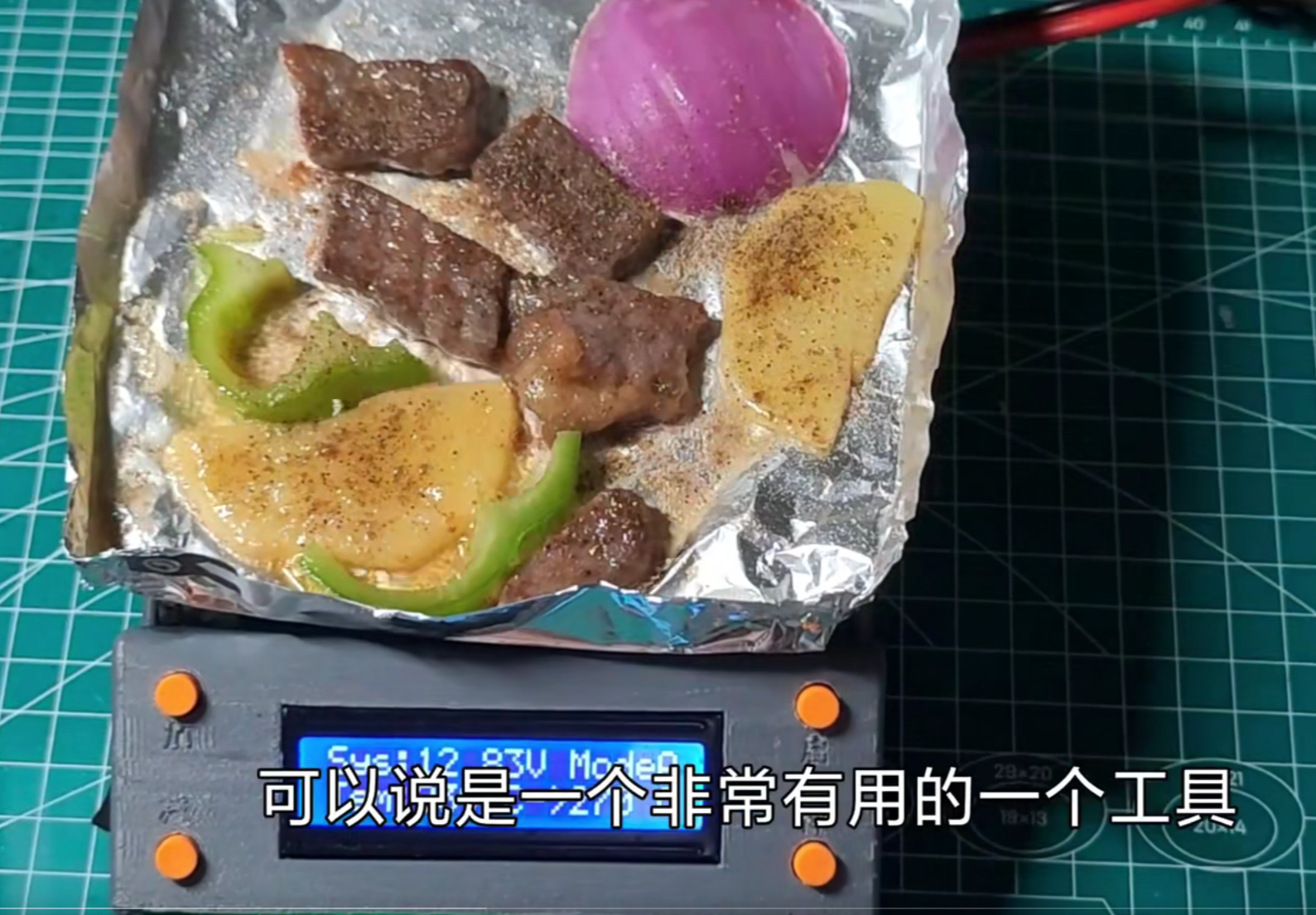

GSH_Bed aluminum base plate heating platform
(Please indicate the source for reprinting and distributing)
Aluminum substrate high temperature soldering station, under rated voltage, can be stable at around 260 degrees at room temperature. It can be directly powered on and used for PCB welding or barbecue. The performance is very stable. If you are interested, please be sure to move Watch the video explanation and some precautions at Step B Station.
I heard that open source will get Sanlian+ attention (dog head)
2021/9/4 update:
Two sizes of heating plates have been newly updated, but they have not been verified by making a board. Feedback is welcome if there are any problems. One is 100*100mm, 150W design power, the other is 100*75mm, 100W design power, which can be placed directly at Jiali. The rated design parameters are listed on the silk screen. The 100*75mm size is specially designed for gallium nitride chargers. The decoy chip here recommends a model, CH224K. There are currently no plans to design a 100W deception circuit for gallium nitride. I will update it depending on my mood.
