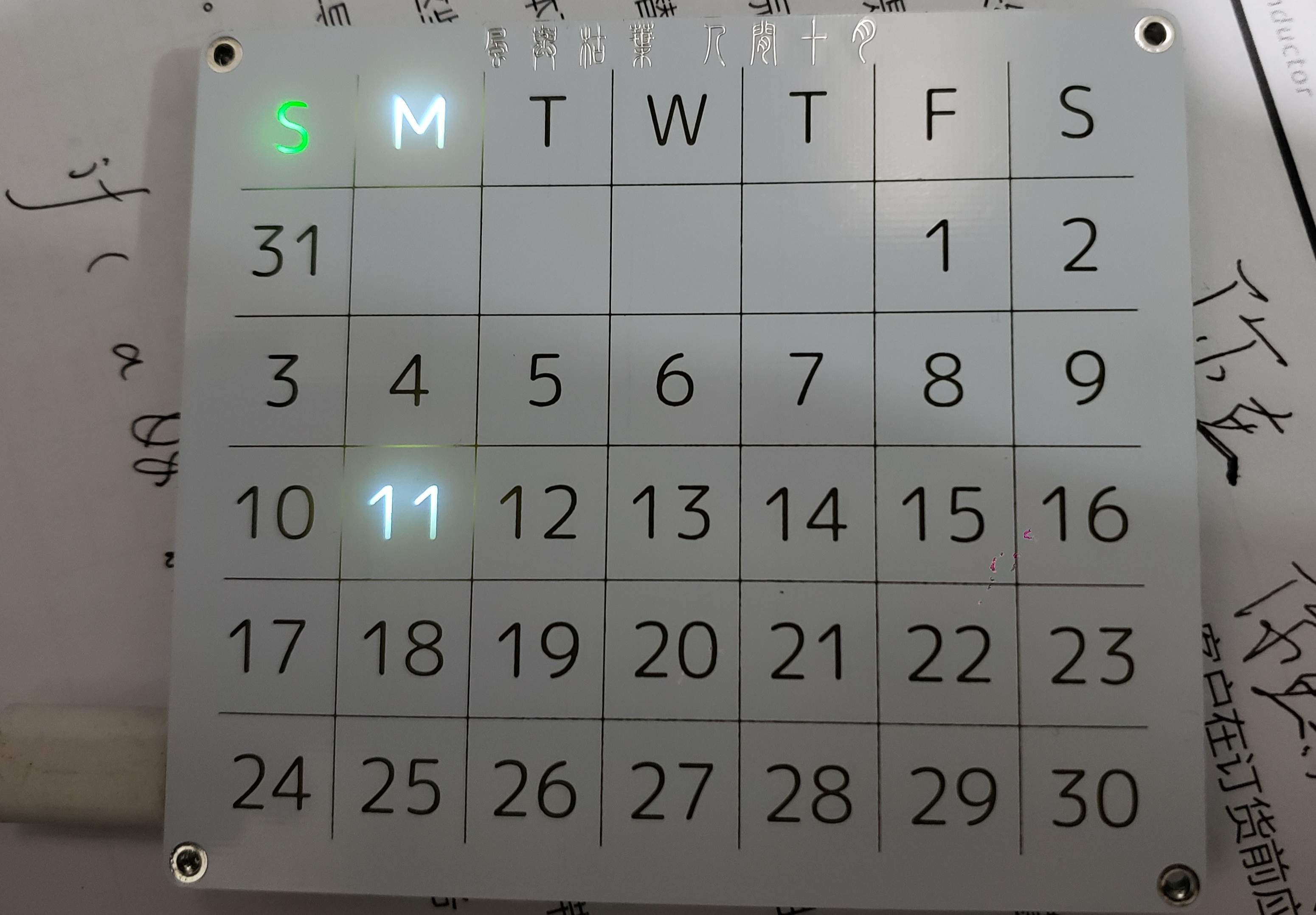

Monthly disposable monthly calendar V2
Improve
Compared with the previous version , there have been many major changes
1. After removing the time display, you can clearly see the qualitative change in thickness.
2. Size reduction. Due to some well-known reasons, the cost of prototyping boards that were originally larger than 10*10 has skyrocketed, so this time the size has been reduced to just the right size of 96.52*83.82mm, which perfectly fits the preferential policies of major platforms.01.png
3. Indicator lights. Due to the powerful driving capability of TM1640, support for dual-color LEDs has been added this time. It can display up to three colors, giving you more options for your calendar! A power indicator light has also been added (only increasing power consumption). What? You mean WS2812? Your money is brought by the strong wind! ! !
4. Added a photoresistor, cut out the useless infrared part, and returned to the original work of the calendar.
This is the part that can be seen directly. In terms of details, although it is V2, I would rather say that this is a completely new design product.
5. The main control uses STM8S103/003 chip. Compared with ESP8266, it is cheaper, has more available pins, is more difficult to weld, and is easier to program.....03.png
6. A calendar is a calendar after all, and it also needs to display time. The DS1302 chip is used here. Although I have a lot of DS1307 in stock at home, I have not adjusted it yet, so I still use the more familiar DS1302. At least I can read the time. Since it is just The calendar does not need to display time, so the accuracy requirements are not that strict, so DS3231 is not used.04.png
New version features
1. Added a buzzer, you can set the hourly time, and you can also add an alarm clock function
It should be noted here that the device used by the buzzer is C95297 .The schematic diagram found in Lichuang Mall is incorrect., when welding or drawing the schematic diagram, pay attention to distinguish the position of each pin. The following two pictures are from the product manuals provided by Lichuang Mall and Lichuang Mall respectively. 2. In order to facilitate the update of DS1302, the corresponding reading and writing are specially introduced. Pins are convenient for using other MCUs to operate it. As shown in the figure, they correspond to the data, clock, and enable pins of DS1302 respectively. 06——1.png06——2.png 07.png

Physical map
20211011_155040.jpg20211011_155034.jpg20211011_153727.jpg20211011_155132.jpg20211011_155530.jpg
Those with spondylosis can move their necks
About the cover
Do not proof the directly generated Gerber files!
Documents printed directly are opaque because the bottom layer is not windowed, so light cannot come through.
You need to unzip the compressed package, delete the original GBS file, and replace it with the GTS file. This will completely copy the top-level window to the bottom layer to achieve a light-transmitting effect.
Below is the effect after replacement. Only in this way will the window positions on the top and bottom floors be exactly the same. In fact, using the professional version can be completed through text mirroring at the bottom level, so there is no need to be so troublesome.
Regarding the choice of panel, I recommend white, which is very clean and has the best visual effect. I have tried purple and green, but the effect is hard to describe.
Regarding the choice of board-making factory, there are not many manufacturers that can make white solder mask at low prices. The results they produce can be seen in the comparison chart:
First up is player number one:
Then there’s player number two:
