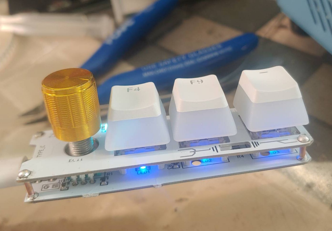

Radio button three-button ch552 hot-swappable improved version
The first position is not enough for two Kaihua axis seats,
and a positioning plate is added with an LED. It can be powered through a copper pillar.
I directly replace it with copper wire.
It has been verified
that I use keil5 to write
the knob volume adjustment and pause
key123 to open the player's previous song and next song. song
