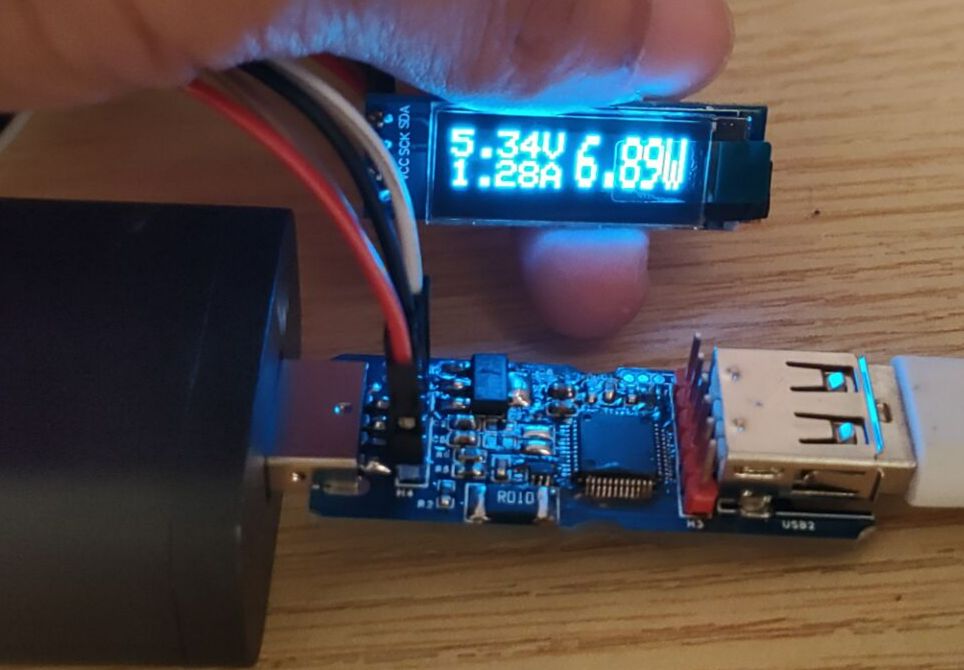

1. Introduction to project functions
#The 7th LiChuang Electric Competition# Summer training camp ammeter can detect the current, voltage and power when USB2.0 is working.
USB ammeter based on N32G430C8L7+INA199, with an accuracy of 1%. It is mainly a reproduction of the functions in the summer training camp example, and the functions have not been changed much!

4. Hardware part
MCU part
N32G430C8L7 related pin configuration, related capacitors should be placed reasonably according to the design manual! You can also open the pcb reference placement method of this project.
Pay attention to the position of pin 1 in actual welding, as shown in the figure below.
The reset circuit and BOOT circuit
refer to the live broadcast of Mo Gong operation. H1 and H2 use two pairs of top pads as contacts
for burning and 0.91-inch oled interface.
This time, PWLINK2 and keil mdk of Chuangxin Workshop are used for download and debugging through swclk and swdio. Current
sampling
INA199A1 gain: 50V/V voltage output, current shunt monitor (also known as current sensing amplifier) ​​is often used for overcurrent protection, precision current measurement or closed-loop feedback circuit for system optimization. This series of devices can sense the voltage drop across the shunt resistor at a common-mode voltage of –0.3V to 26V independent of the power supply voltage. This series of devices uses a zero-drift architecture with low offset, so the maximum voltage drop across the shunt resistor can be kept at a minimum of 10mV full scale when current sensing is performed. These devices are powered by a single power supply of 2.7V to 26V and consume a maximum power supply current of 100µA. All versions are rated for –40°C to 125°C.
When laying out the PCB, pay attention to the placement and routing of the sampling resistors. Refer to the Kelvin routing in the manual.
When purchasing original parts, pay attention to the difference in gain (this program uses x1: 50V/V)
INA199x1: 50V/V
INA199x2: 100V/V
INA199x3: 200V/V.
Also pay attention to the position of pin 1 when soldering.

Picture display (Since the mother row was not purchased and there was no extra screen, the DuPont line connection method was adopted)
O6AKgjUhJis1xDrEO7Prbz3ZEVdJXHtI8XIKWzNg.pngVideo demonstration
