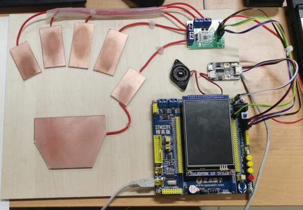

Physical display description
Figure 13 System block diagram
          is shown in Figure 13. This device It can be divided into 4 parts in total:
Area 1 is the copper plate part, which is directly connected to the four channels of the FDC2214 capacitive sensor module. In order to facilitate data collection and processing, we cut the copper plate into six pieces to accurately collect gestures and avoid recognition errors.
Area 2 is the FDC2214 capacitive sensor module, which communicates with STM32 through IIC, feeds back the identified capacitance value to the processor, and performs subsequent operations such as threshold comparison.
Area 3 is the voice broadcast module. The control core sends voice broadcast instructions to JQ8400-FN through the serial port, and the voice prompts the gesture status and the winning or losing relationship in the guessing mode.
Area 4 is the STM32F103 microcontroller, which serves as the control core of the microprocessor module. And the TFTLCD screen is used to display the system menu and judgment results to enhance the degree of visualization.
