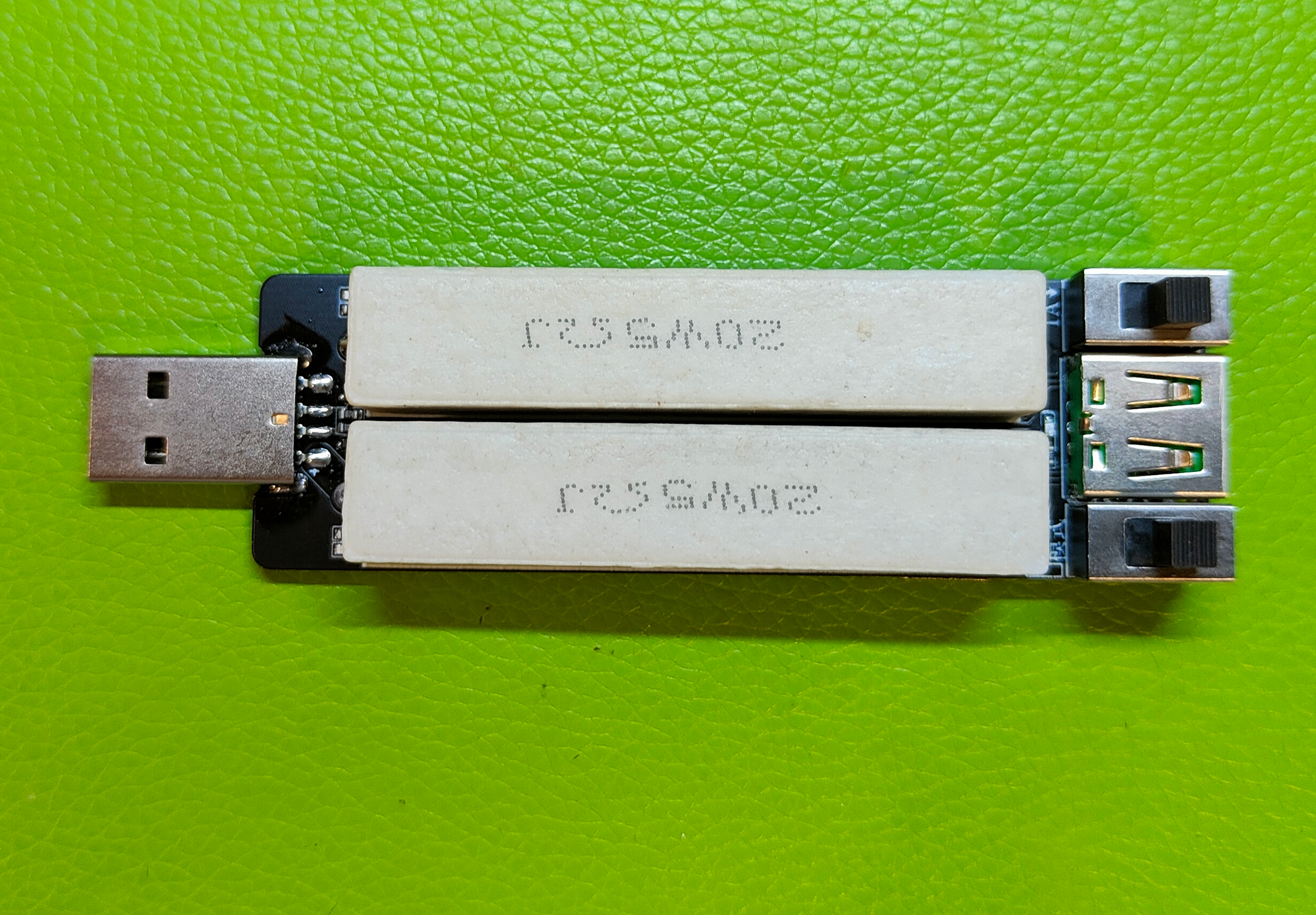

Two noble 20W5R cement resistors are used.
Can be used as an ordinary 1/2A dummy load.
It can also be used to test the internal resistance of data lines.
The principle is that the data line output +- is short-circuited. Then use D-D+ to measure the +- voltage of the data line input respectively. A cement resistor is connected in series between the data line + and the power input.
