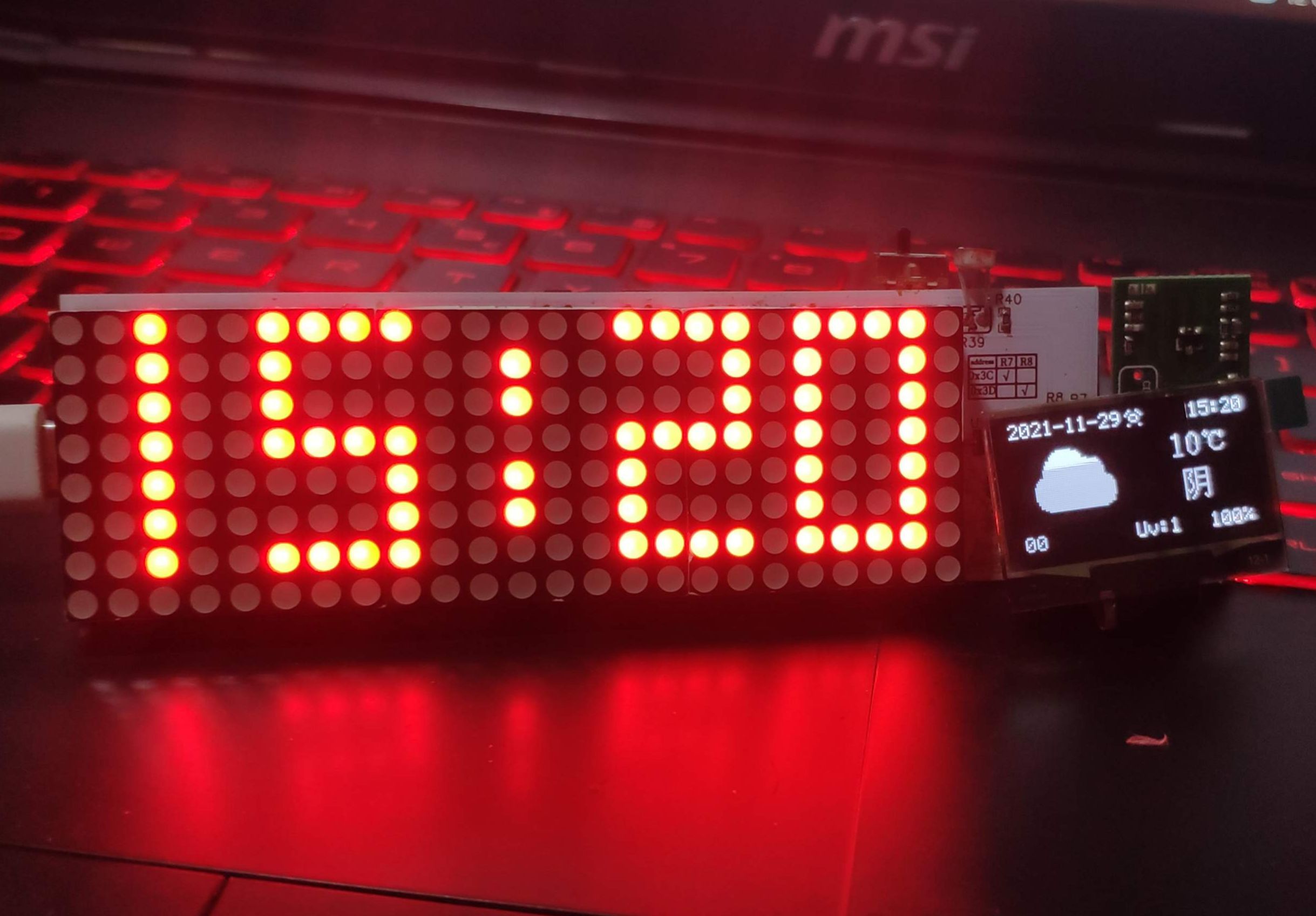

uses esp8266 to drive three max7219, three dot matrix, one 128x64 OLED, and one PCF8563M, which can obtain weather and automatically adjust the time.
### Project function introduction
* The main control uses esp8266
* The display part uses max7219 to drive the dot matrix to display digital time, and a 1.3-inch OLED to display weather and human-computer interaction
* The clock uses PCF8563M as the clock module, and added Battery
* Use three I/O ports to make four buttons for human-computer interaction
* Use a photoresistor on the ADC port to adjust the dot matrix and screen brightness
* Use a microwave module to detect whether there is human activity, which can be used with the photoresistor to provide night information screen
* and can plug in an mp3 playback module to realize weather voice broadcast
* Independent OLED driver library, rich animations
