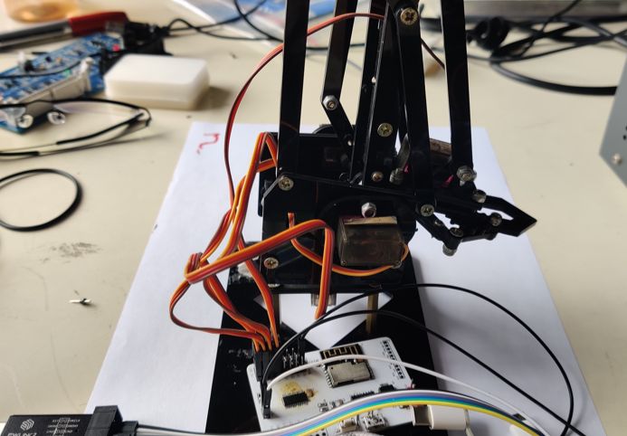

Project Introduction This project uses the exclusive MCU for this training camp, HI3861, and a chip for LED control, PCA9685 (I don’t know if the little genius thought of using this chip to control the servo). The controller can achieve up to 16 Road steering gear control. In the modified picture, I added a USB to TTL interface to facilitate direct downloading. The CH340G chip is used, no external crystal oscillator is needed. Because the things being made do not need to be moved, a 5v voltage conversion was removed to save costs. The end of the robotic arm was heavily loaded, resulting in insufficient power supply to the computer port, so a DC voltage source was used for power supply. Control method: The robotic arm has four 5v servos, which control the direction, hand lift, arm extension, and clamping claw respectively. The maximum angle is toward the left of the base. The angle will also change when the installation method is different. Due to the heavy load on the upper arm, the computer's port output current cannot be driven (excessive current may burn the port), so it is recommended to use a voltage source for power supply.image.png
