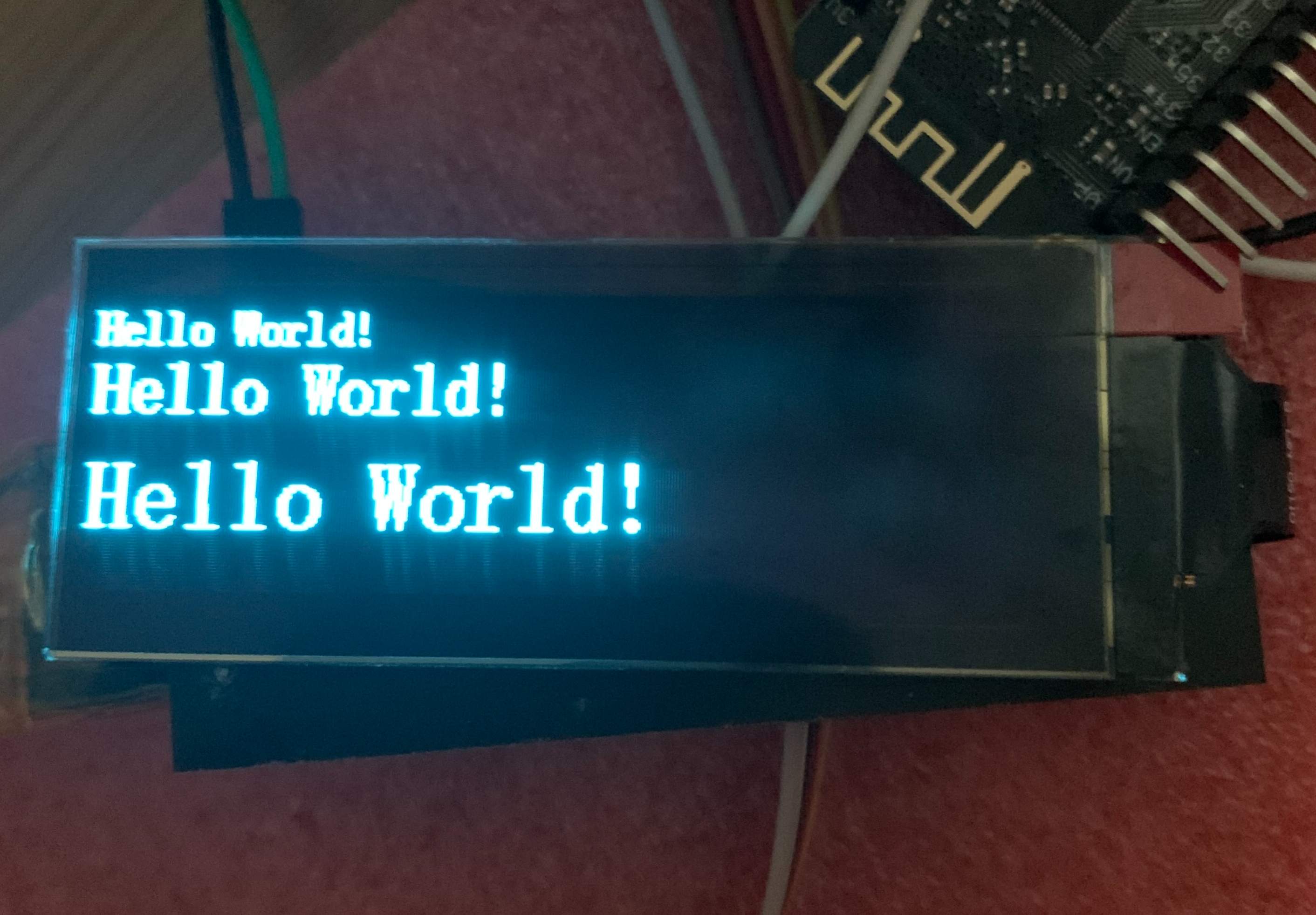

OLED 2.45-inch 305x96 SH1126G HD screen display module
0.3MM pitch FH26W-31P-0.3SHW clamshell FPC socket purchase address
3.7V to 12V purchase address You need to select the solder joint to the 9V
screen base plate to support I2C SPI.
Draw one according to the information given.
It should be noted that the definition on the schematic diagram is exactly the same as the interface. On the contrary, it has been realigned and verified to be able to light up normally.
