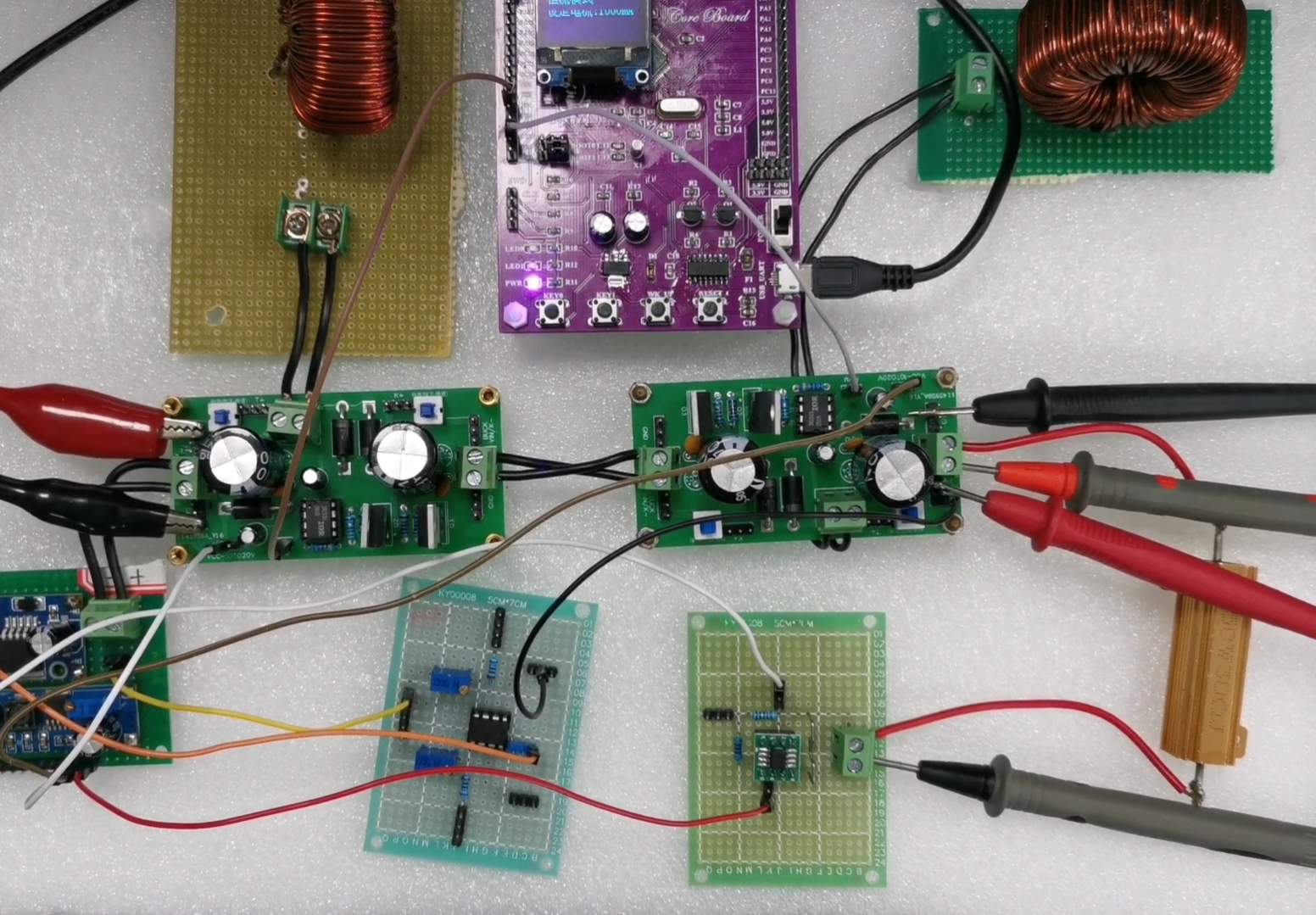

The system consists of five parts: main circuit module, auxiliary power supply module, measurement module, control module, and display module. The main topology adopts a buck-boost chopper circuit. Its basic principle is to connect two universal half-bridge boards in series, connect the same-name ends, and form a full-bridge circuit. A fixed resistor R1 is connected after the buck-boost chopper circuit to form a DC electronic load circuit. The auxiliary power supply module uses the mc34063 boost circuit to take power from the microcontroller and increase it to 12V to power the sampling circuit and control circuit. The sampling circuit includes voltage sampling and current sampling. The voltage sampling is composed of a voltage divider resistor and the current sampling is composed of an INA282 current detection chip. The control module is based on STM32F103. The sampling voltage and current are obtained through the sampling circuit. The PID algorithm is used for constant current and constant resistance control, and the display module displays in real time. In addition, we added a wireless remote control to change the system mode. The system block diagram is shown in Figure 3.

The main circuit is composed of a buck-boost chopper circuit and a high-power fixed resistor. A fixed resistor R1 is connected after the buck-boost chopper circuit to form a DC electronic load circuit. The system can work stably in two modes, namely constant current mode (CC) and constant resistance mode (CR). The main circuit topology is shown in Figure 4.
In constant current mode, it is required to keep Ui constant, that is, when Ii changes, Ui remains unchanged. From the law of conservation of power, it can be seen that in order to achieve constant Ii, when Ui increases or decreases, Uo needs to be increased or decreased. By adjusting the duty cycle of the switch tube to change the voltage gain of the buck-boost chopper circuit, Uo changes in the same direction as Ui, and finally realizes the function of constant input voltage at the load end.
In constant resistance mode, it is required to keep the equivalent resistance Radj unchanged, that is, when Ui changes, Radj remains constant. From the law of conservation of power, it can be seen that in order to achieve constant Radj, when Ui increases or decreases, Uo needs to be increased or decreased. By adjusting the duty cycle of the switch tube to change the voltage gain of the buck-boost chopper circuit, Uo changes in the same direction as Ui, and finally realizes the function of constant input voltage at the load end.
Switch tube selection: The peak voltage of the MOSFET tube in this system is 30V. Considering the voltage spike during the switching process, a 50% margin is reserved. When the circuit is working normally, the maximum current passing through the switch tube is about 2.5A, so the withstand current is preferably greater than 3A. Considering that the switch tube loss should be reduced as much as possible, the N-channel MOS tube SET0178 is selected, with a withstand voltage of 100V. Inductor
selection: Considering the high efficiency requirements of the system, the leakage inductance of the inductor should be as small as possible. When the circuit is working, it is important to avoid inductor saturation and excessive temperature rise. Iron silicon aluminum magnetic rings with strong peak current bearing capacity and low EMI should be used, and their leakage inductance is extremely small.
Capacitor selection: In the main topology, the voltage input and output side capacitors will directly affect the voltage ripple. Since the problem has high requirements for voltage stability, a large-capacitance electrolytic capacitor is selected in parallel with a high-frequency ceramic capacitor to suppress the ripple as much as possible.

Connect a 25Ω100W high-power resistor to the buck-boost chopper circuit to form a DC electronic load. By changing the voltage of the regulated power supply, the circuit indicators under different states can be tested. Combined with the test reference wiring diagram in the question, set appropriate voltage and current test points, and use a 5.5-digit benchtop multimeter and a 3.5-digit handheld multimeter to test the corresponding voltage and current values.
Test instruments: DC regulated power supply, 5.5-digit benchtop multimeter, 3.5-digit handheld multimeter.
