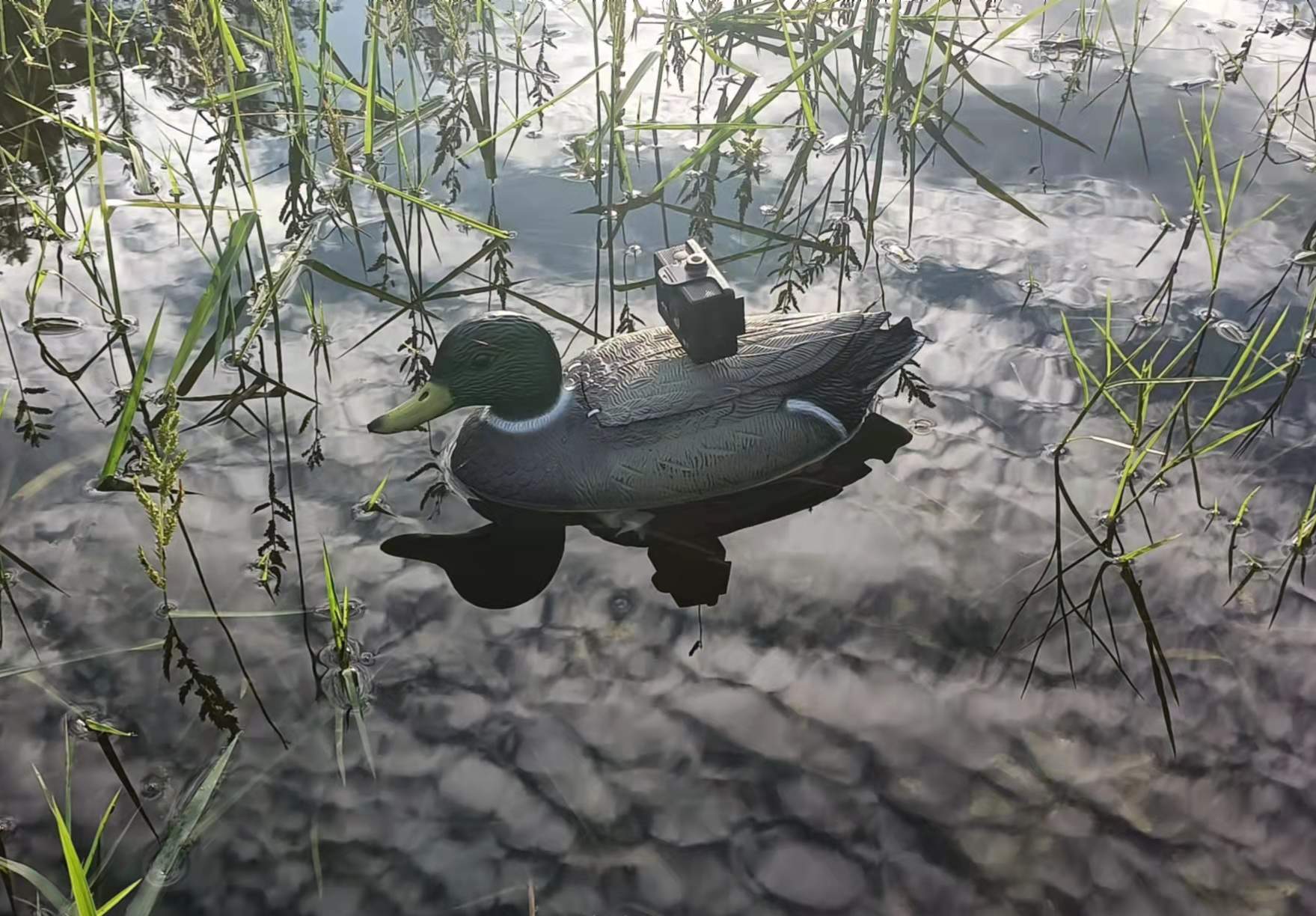

This time, a domestically produced 2.4G+MCU packaged chip is used. It is an integrated chip produced by Yuxin Microelectronics. It codes an 8-function remote control car IC and controls the forward and reverse rotation of 4 sets of motors at the same time.
Also used with 1818AM, each one has two H-bridges integrated inside, which can directly drive two DC motors. The average output current of 1.8 A is enough to satisfy this application scenario.
The main features are
low power consumption, convenient design, and saving hardware costs. The bottom layer of the chip has its own communication protocol, and the onboard micro-antenna can be used. As long as simple peripheral circuits are used, it can work normally.
This modification is very convenient.
A charge and discharge management TP4056 is added to the launch board, which saves you the trouble of finding a battery.
A small 200 mAh battery, thanks to its low power consumption, can also be played for an entire afternoon, but it still has a launch distance of 50 meters.

In order to save costs, a miniature water pump was used to modify the submersible motor with moderate power. Buy a horizontal type with 2 pairs of front and back blades.
Modify the motor and install it like this. It is recommended to use AB or hot melt glue when bonding, and 704 silicone rubber for waterproofing.
The three channels are used to control the entire duck, forward, backward, (turn left, turn right, use one channel)
, and the two-layer grip is more comfortable.
This channel of SW is used here to control the pause and start of the player.
For example, you can use it to light firecrackers wirelessly during the New Year, haha~
There is a first-person perspective video in the attachment.
At this point, our little duck has been modified. Let’s quickly call our friends to modify one! Come on
