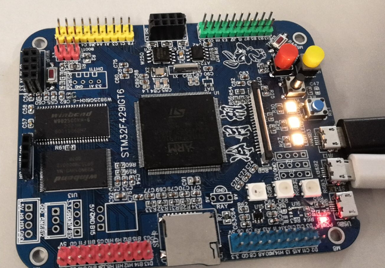

Introduction:
This is a development board based on STM32F429. It was a development board I made when I was learning STM32 a long time ago. At that time, the chip price was still very cheap (about 30 yuan). At that time, I just learned the STM32F103 series of microcontrollers. I wanted to change my studies to a more advanced one. I didn’t know much about it at the time, so I drew this board by referring to the principles of wildfire. After I built the board and soldered it for testing, there was basically no problem. However, there were some things that delayed me and I didn’t have time to study. I've been putting it aside, so I'll take some time today and open source it.
1. Interface
This development board has many interfaces. I combined the functions of Wildfire to select some commonly used devices, removed some uncommon interfaces, and added some interfaces that I thought might be used, and also introduced most of the pins. Very easy to expand.
PCB preview image.pnginterface includes:
ST_link interface, serial port, USB interface
Button, LED
DHT11
OLED (IIC interface)

2. Design
I made this trace in the PCB blindly (leaving tears of unskilled eyes). In order to trace the traces of equal lengths, the frequencies may not need to be of equal length, and the impact will not be big.
Some other details, it took too long to remember.
3. Functional testing
Currently, I have tested W25Q, AT24, NRF24L01, ESP8266, RGB screen, NAND flash, SD card, WS2812, LED, etc. (because I have no time to play, I have been working on linux recently)
4. Design defects
1.W25Q
At present, I have found one place. In W25Q, I found that the ground below is not connected, which causes W25Q to not work and can be operated by flying wire.
Version 2.0 has been modified in both schematic and PCB.
2.micro usb interface
There are three micro USB interfaces on the board, but these three interfaces are too close and may be crowded when plugged in. You can modify them by yourself. image.png
Other defects have not been discovered yet, and we look forward to everyone correcting them.
