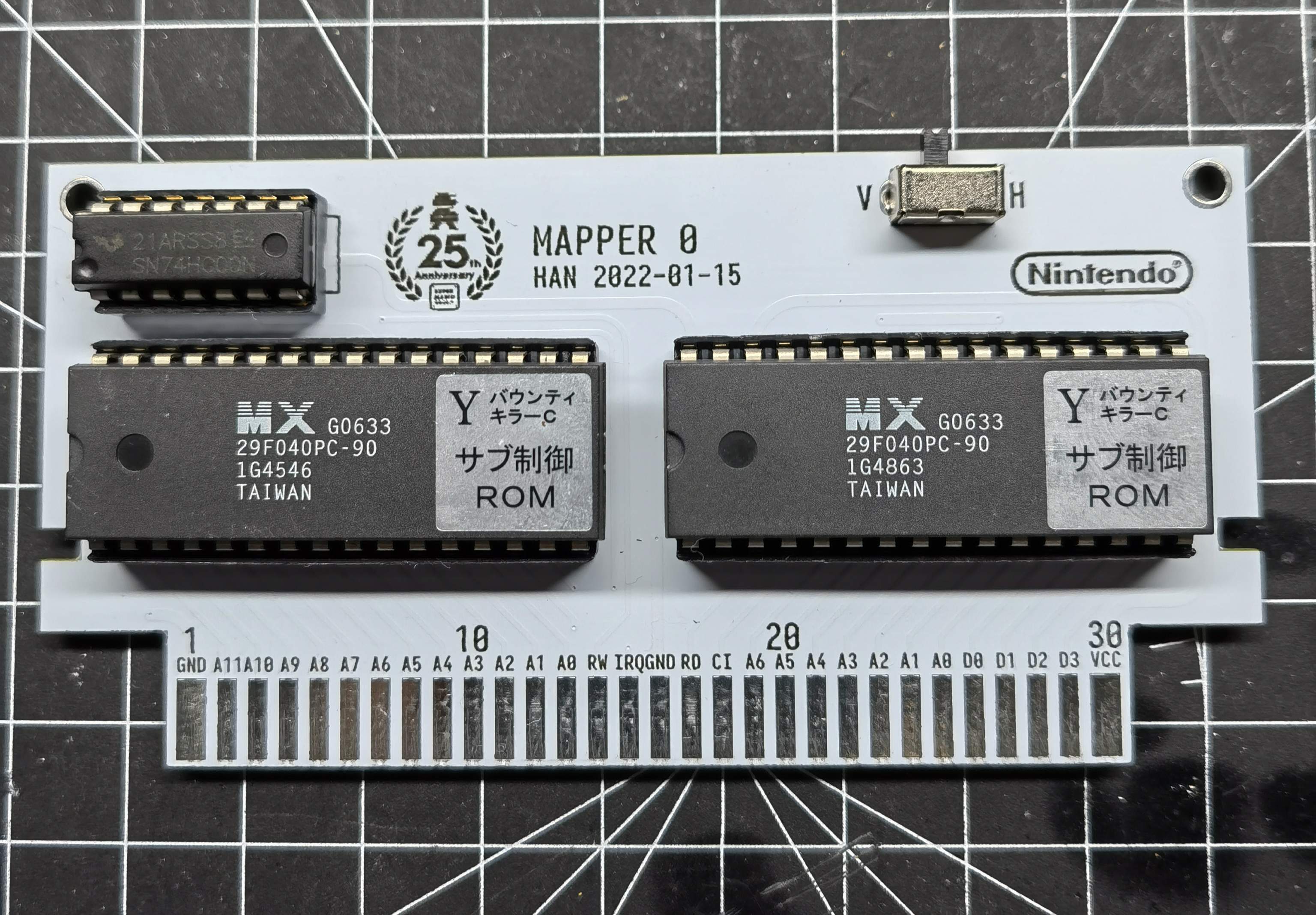

FC red and white machine game flash card Mapper0
The FC red and white machine game burning card Mapper0
is being printed and has not yet been verified. It needs to cooperate with kazzo (click here to go to the kazzo project) to burn the game.
Proofing has been completed on 2022-01-22. One problem has been fixed. If you need proofing, please Use mapper0 to temporarily test the subsequent four-in-one and four-in-one experimental cards.
The proofing thickness needs to be 1.2mm.
MAPPER4 can also be used directly. Just search it in Kaiyuan Square.
