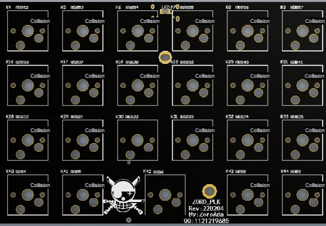

Planck keyboard, 40% layout, three modes
1. The only correction to the inverted shaft light is that the shaft seat may need to be polished before it can be installed.
2. Only steel plate satellite shafts can be used, and the space is limited.
The light control uses is31fl3733
8 bottom lights WS2812_5050
4 ws2812_2020 package status indicators (light 1: caps, numlock, light 2: Bluetooth 1: red, Bluetooth 2: blue, Bluetooth 3: green and 2.4G indicator: white, light 3 : Layer indicator, light 4: USB indicator) With driver, it can be modified at will.
Use U disk to drag and drop to upgrade the firmware.
