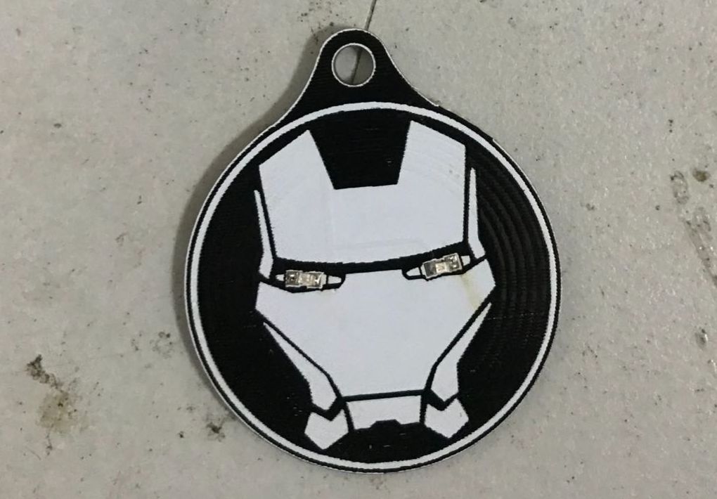

Water drop access card puzzle
The copied https://oshwhub.com/liujigang/shuidimenjinka made a panel to maximize the use of the pcb
panel placed in one order. The size is within 10*10, and the connection area is enlarged. It complies with the production specifications and
has been verified by the board.
