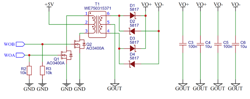

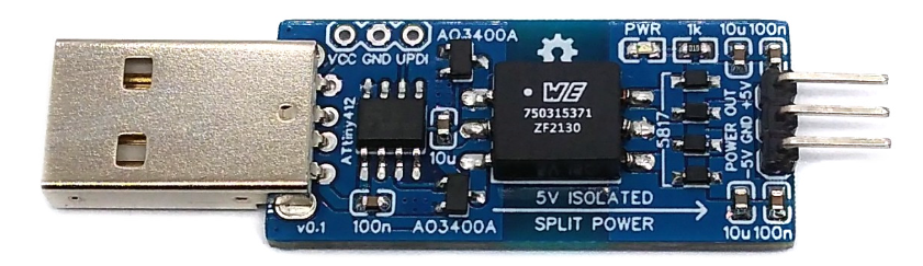

Low-cost 2.5KV USB power isolation solution (schematic + BOM + gerber, etc.)
This is a low-cost isolation achieved through a power transformer. Since the transformer is more convenient for AC isolation, but DC is not suitable, ATtiny412 is specially used for control.
