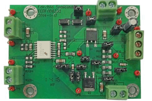

FEBFOD8333-GEVB: Input LED drive, 2.5 A output current, IGBT drive optocoupler with desaturation detection, isolation fault detection and active Miller clamp
FEBFOD8333-GEVB: Input LED Drive, 2.5 A Output Current, IGBT Drive Optocoupler with Desaturation Detection, Isolated Fault Sensing, and Active Miller Clamp
Fairchild FEBFOD8333-GEVB smart gate driver optocoupler, an advanced 2.5 A output current IGBT drive optocoupler, offers the critical protection necessary for preventing fault conditions that lead to destructive thermal runaway of IGBTs. Pin-for-pin compatible with current solutions, the FEBFOD8333-GEVBconsists of an integrated gate drive optocoupler
featuring low RDS(ON) CMOS transistors to drive the IGBT from rail-to-rail and high-speed isolated feedback circuitry for fault sensing. It is ideally suited for driving fast- switching power IGBTs and MOSFETs. FEBFOD8333-GEVB herein refers to FOD8332 or FOD8333. The key difference between these two products is the reset mechanism. The
FAULT signal is reset when VLED1+ is pulled from LOW to HIGH for FOD8332 or automatically after tDESAT(MUTE) for FOD8333.
The FEBFOD8333-GEVB offers best-in-class noise immunity, resulting from its proprietary Optoplanar® coplanar packaging technology. The optoplanar technology ensures safe insulation thickness of more than 0.4 mm in attaining reliable high-voltage isolation, certified by UL1577 and DIN EN/IEC60747-5-5 standards.
Features and Applications
2.5 A Output Current Driving Capability for Most Medium Power IGBTs
High Noise Immunity Characterized by CMR: 35 kV/µs at Vcm = 1500 Vpeak
1414 Vpeak Working Insulation Voltage and 8000 Vpeak Transient Isolation Voltage Rating
Output Voltage Swing Rail-to-Rail: Low Power Dissipation
Soft IGBT Turn-Off
High Speed: 250 ns Propagation Delay
3.3 V / 5 V, CMOS/TTL-Compatible Inputs
Induction Heating
Uninterruptible Power Supplies (UPS)
Solar Power Inverters
Industrial Inverters
Motor Drives
Isolated IGBT Drive
