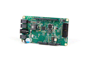

The NCL31000ASGEVB is an Arduino shield form factor evaluation board containing a single NCL31000MNITWG intelligent LED driver. It can be connected either with the Arduino interface to an MCU board, or through the I²C interface, for example via a USB adapter board to the PC.
The NCL310xx family of intelligent LED drivers target luminaire applications. The NCL31000 incorporates a high efficiency buck LED driver that supports both high-bandwidth analog and PWM dimming down to zero current. Two auxiliary DC-DC converters are included to power a microcontroller and other peripherals, such as sensors. Diagnostics are included to measure input and output current and voltage, LED temperature and DC-DC voltages. The device is ideal for Visible Light Communication and Indoor Positioning.
Features and Applications
Arduino Shield compatible
Visible Light Communication capable / YellowDot™ compliant
>97 % Efficiency of total solution, incl EMC, DC-DC’s, diagnostics, etc
High linearity and 0,1% accuracy, true dimming to zero
Input voltage 24 up to 57V
LED Power capability beyond 100W
Optional I2C/SPI interface (NCL31000MNITWG I²C variant mounted)
Connected indoor & outdoor lighting
Multi-channel managed lighting
Theater lighting
Therapeutic lighting
Information displays
Backlighting
Hazardous or sensitive environments
