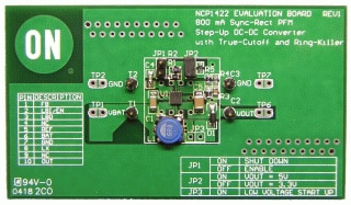

The NCP1422 is a monolithic, micropower, high frequency, step-up switching converter IC designed for battery-powered handheld electronics with load currents up to 800 mA. It integrates a synchronous rectifier (Sync-Rect) to improve efficiency and eliminate external Schottky diodes. The high switching frequency of the NCP1422 (up to 1.2 MHz) allows the use of thin, small-size inductors and output capacitors. When the device is disabled, the internal conduction path from the battery to the load is completely blocked, isolating the load from the battery. This True-Cutoff feature reduces the shutdown current to typically only 50 nA. A Ring-Killer is also integrated to eliminate high-frequency ringing in discontinuous conduction mode. Finally, low battery detector, logic-controlled shutdown, cycle-by-cycle current limit, and thermal shutdown provide value-added features for a variety of battery-powered applications. With all these features turned on, the quiescent supply current is typically only 8.5 uA. The device is available in a compact, low-profile DFN-10 package. The NCP1422 Evaluation Board can be configured to output 3.3 V or 5.0 V by removing or adding the JP2 jumper. The 5.0 V configuration can provide up to 800 mA at Vin = 3.6 V, and the 3.3 V configuration can provide up to 800 mA at Vin = 2.5 V. The board also includes a low voltage startup circuit that can be enabled via the JP3 jumper. Features and Applications FeaturesHigh Efficiency: - 94% efficiency at 2.0 V input, 200 mA output current, 3.3 V - 84% efficiency at 2.5 V input, 500 mA output current, 3.3 V High Switching Frequency, up to 1.2 MHz (without reaching current limit) True-Cutoff feature reduces device shutdown current to 50 nA typical Ring-Killer for Discontinuous Conduction Mode Space-Saving 3mm x 3mm DFN-10 PackageThe
NCP1422 is a monolithic, micro-power, high-frequency, step-up switching converter IC designed for battery operated hand-held electronic products with up to 800 mA loading. It integrates a synchronous rectifier (Sync-Rect) to improve efficiency and to eliminate the external Schottky Diode. The NCP1422's high switching frequency (up to 1.2 MHz) allows for a low profile, small sized inductor and output capacitor to be used. When the device is disabled, the internal conduction path from the battery to the load is fully blocked, which isolates the load from the battery. This True-Cutoff function reduces the shutdown current to typically only 50 nA. A Ring-Killer is also integrated to eliminate high-frequency ringing in discontinuous conduction mode. Finally, a Low-Battery Detector, Logic-Controlled Shutdown, Cycle-by Cycle Current Limiting and Thermal Shutdown provide value-added features for various battery operated applications. With all these functions on, the quiescent supply current is typically only 8.5 uA. This device is available in the compact and low profile DFN-10 package.The NCP1422 evaluation board can be configured to output 3.3 V or 5.0 V by removing or adding, respectively, the JP2 jumper. The 5.0 V configuration sources up to 800 mA with Vin = 3.6 V, and the 3.3 V configuration sources up to 800 mA with Vin = 2.5 V. The board also includes a low-voltage, startup circuit that can be enabled with the JP3 jumper.
