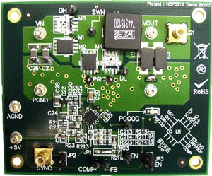

NCP5212AGEVB: Synchronous Buck Controller Evaluation Board
NCP5212AGEVB:  Synchronous Step-Down Controller Evaluation Board
The NCP5212A/NCP5212T is a synchronous step-down controller for high performance systems battery-power systems. The NCP5212A/NCP5212T includes a high efficiency PWM controller. A pin is provided to allow two devices in interleaved operation. An internal power good voltage monitor tracks the SMPS output. NCP5212A/NCP5212T also features soft-start sequence, UVLO for Vcc and switcher, over-voltage protection, over-current protection, under-voltage protection and thermal shutdown. The IC is packaged in QFN16.
Features and Applications
0.8% accuracy 0.8 V Reference
4.5 V to 27 V Battery/Adapter Voltage Range
Adjustable Output Voltage Range: 0.8 V to 3.3 V
Synchronization Interleaving between Two NCP5212A/NCP5212Ts
Skip Mode for Power Saving Operation at Light Load
Lossless Inductor Current Sensing
Programmable Transient-Response-Enhancement (TRE) Control
Programmable Adaptive Voltage Positioning (AVP)
Input Supply Feedforward Control
Internal Soft-Start
Integrated Output Discharge (Soft-Stop)
Build-in Adaptive Gate Drivers
PGOOD Indication
Over-voltage, Under-voltage and Over-current Protections
Thermal Shutdown
These Devices are Pb-Free and are RoHS Compliant
Notebook Computers
Tablet Computers
System Power
