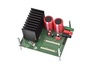

SECO-MDK-4KW-65SPM31-GEVB: 4kW 650V Industrial Motor Control Power Board with Compact Intelligent Power Module (IPM)
The SECO-4KW-65SPM31-GEVB is a complete reference design for three-phase motor drives, part of the Motor Development Kit (MDK). The board features the NFAM5065L4B Intelligent Power Module in a DIP39 package and rated for 400 VDC input, delivering up to 4 kW of power. The board is fully compatible with the Universal Controller Board (UCB), based on the Xilinx® Zynq®-7000 SoC, which embeds FPGA logic and two ARM® Cortex-A9 processors. As such, the system is fit for high-end control strategies and enables operation of a variety of motor technologies (AC induction motor, PMSM, BLDC, etc...). The graphical user interface ensures an easy startup for evaluation purposes running voltage/frequency control.
As part of the Motor Development Kit (MDK), the Compact IPM Motor Drive is compatible with the powerful Universal Controller Board (UCB), enabling high-end control strategies and AI capabilities for industrial motor control. The SECO-MDK-4KW-65SPM31-GEVK comprises of the SECO-MDK-4KW-65SPM31-GEVB and the Universal Controller Board (UCB).
To order the motor power board bundled with the UCB go to SECO-MDK-4KW-65SPM31-GEVK.
Features and Applications
4 kW motor control solution supplied up to 410 VDC
Downloadable V/f and FOC control use cases for the UCB
MDK FPGA-controller based on Xilinx® Zynq®-7000 SoC, including a dual 667 MHz CPU Cortex A9 core with freely configurable digital peripheral, 32 Mbyte Flash, up to 1 GB RAM, USB / UART / JTAG interface, on-board Ethernet phy, bootloader capability via micro SD card, 10 ADC channel, using NCD98011, and 12 complementary PWM channels, capable of delivering advanced networked motor and motion control systems
Highly integrated power module NFAM5065L4B containing an inverter power stage for a high voltage 3-phase inverter in a DIP39 package delivering
DC/DC converter producing auxiliary power supply 15 VDC - non-isolated buck converter using NCP1063, DC/DC converter producing auxiliary power supply 5 VDC - non-isolated buck converter using FAN8303, and LDO producing auxiliary power supply 3.3 VDC - using NCP718
Three-phase current measurement using 3 x NCS20166 operational amplifiers
Three-phase inverter voltage and DC-Link voltage measurement – using resistive voltage divider circuit
512 kB EEPROM I2C – using CAT24C512
Encoder Interface compatible with either 3-HALL sensors 1 Channel Quadrature encoder
Temperature sensing via build in thermistor
Over current protection using NCS2250 comparator
Xilinx® development tools and environments are available for the MDK, such as Vitis and Vivado to program the FPGA
Motor Development Kit (MDK)Compatible with the Universal Controller Board (UCB) FPGA/ARM
Fully compatible with Xilinx® development tools for Zynq®-7000
White Goods
Industrial Fans
Industrial Automation
