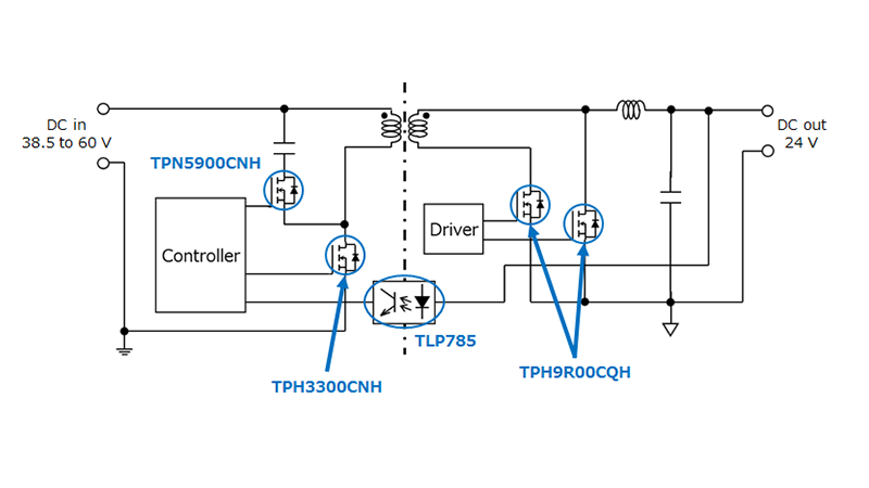

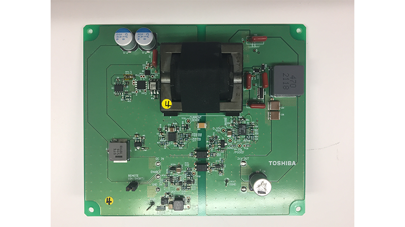

This reference design provides design guidance, data, and other content for a 200W active-clamp forward DC-DC converter using N-channel MOSFETs as clamp switches. Description Input voltage DC 38.5V to 60V Output voltage DC 24V Output power 10W to 200W Circuit topology Active clamp forward + synchronous rectification Features 200W active clamp forward DC-DC converter Appearance photo Total efficiency: 90.8% ( Vin=48V, under 100% load condition) Dimensions: 130mm×115mm×30mm (excluding input and output terminals on the back) Provide solutions using suitable power MOSFETs and optocouplers

Blockdiagram
