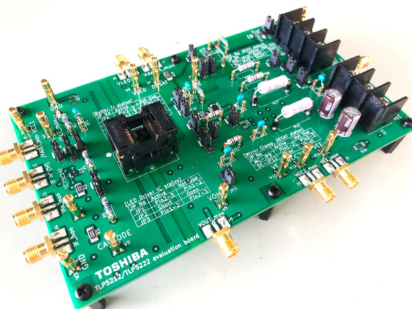

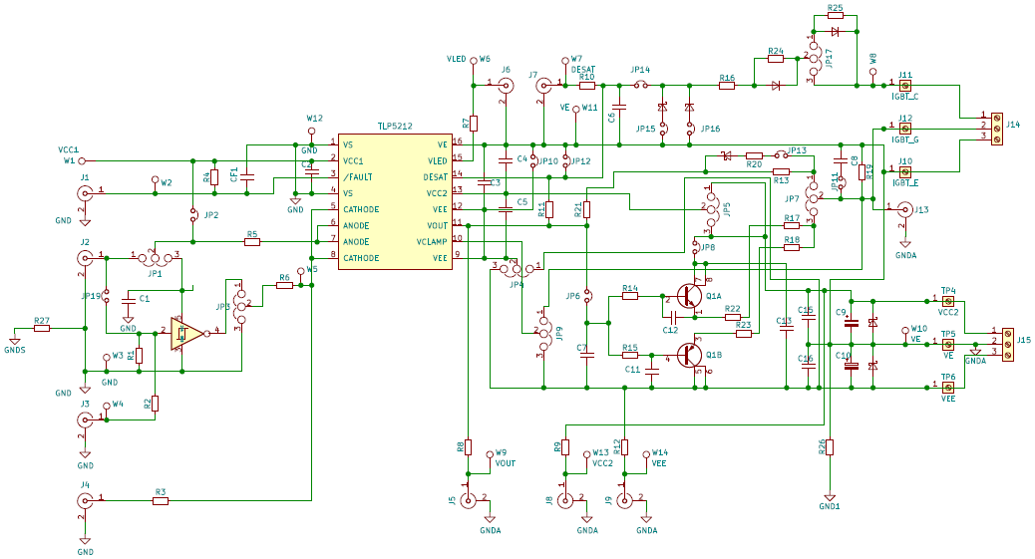

Smart Gate Drive Coupler Evaluation Board
This reference design provides design guidelines, data and other content for the Smart Gate Drive Coupler evaluation board. Description Smart Gate Drive Coupler for easy evaluation Option to drive LEDs, drive buffer transistors or drive IGBTs/power MOSFETs Adjustable various circuit constants and option to enable or disable internal functions Features Board image of Smart Gate Drive Coupler evaluation board IGBT desaturation detection Isolation fault status feedback IGBT soft switching Active Miller Clamp (AMC) Undervoltage lockout (UVLO)
