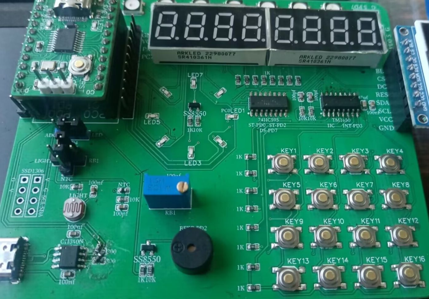

In the BOM table of a development board designed using CH32V003,
except for the core board and pin headers, all the mall components have been matched. You can directly delete the components based on the ones you have on hand and place an order.
The core board link is https://oshwhub.com/ 0x49181f36/ch32v003f4p6-hu-xin-ban-v1-1
can learn 74HC595 8-bit serial input and parallel output displacement register (verified)
digital tube running light (verified)
serial port communication (verified)
PWM wave (verified ) Verified)
ADC (verified)
TM1650 IIC communication matrix keyboard (verified)
SSD1306 IIC screen
ST7735 SPI screen can be DMA (verified)
WS2812 Phantom TIM method can be DMA (verified)
This development board example code has been uploaded
to use the keyboard You cannot use LEDs when using the ST7735 (if you are using a keyboard, use a digital tube).
You cannot use a digital tube when using the ST7735 (if you are using a screen, don’t use a digital tube).
