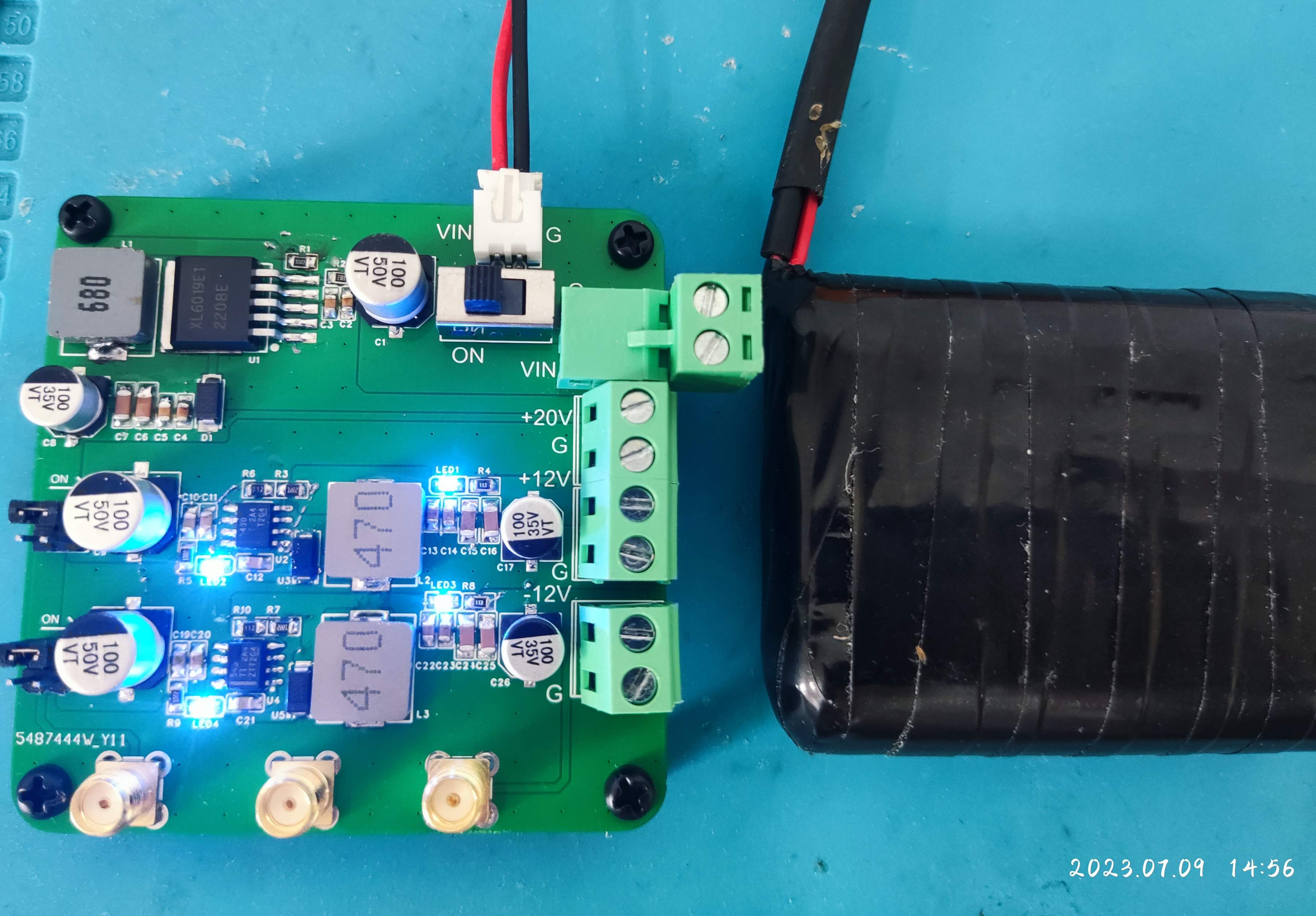

Portable auxiliary power supply XL6019 + TPS5430 auxiliary power supply.
On the one hand, this power supply board is used for training in electric competitions, which really requires a power chip with strong load capacity to meet the needs. On the other hand, it is also a practical exercise of the knowledge learned and exercise of ability. The main idea is to use 6019 to boost the voltage first, and then cooperate with 5430 to reduce the voltage. This solution is a direct application of the BUCK and BOOST structure and there is nothing special about it. Of course, BUCK-BOOST power chip can also be used, but its load capacity and price cannot be guaranteed. It can be directly powered by common 5V and 12V batteries, which is more convenient to use.

following figure is a physical verification figureThe
above figure is a physical display of a 12V lithium battery after being boosted by XL6019The
above figure is a physical display of a TPS5430 stepping down to 12vBecause the types of SMD resistors used are limited, this error is also within the acceptable range. If there are strict requirements for the output voltage, you can replace the voltage-dividing feedback resistor by yourselfThe
above figure is a verification figure of negative voltage output using TPS54300Because
the types of SMD resistors used are limited, this error is also within the acceptable range. If there are strict requirements for the output voltage, you can replace the voltage-dividing feedback resistor by yourselfOverall
physical figureBe
sure to pay attention to the positive and negative when connected to the XH plug of the 12V lithium battery (don't ask why, you must pay attention)
In this scheme, only the output +12V and -12V are verified, but the circuits for outputting other voltage values ​​are also similar. You only need to change the voltage-dividing feedback resistor.
