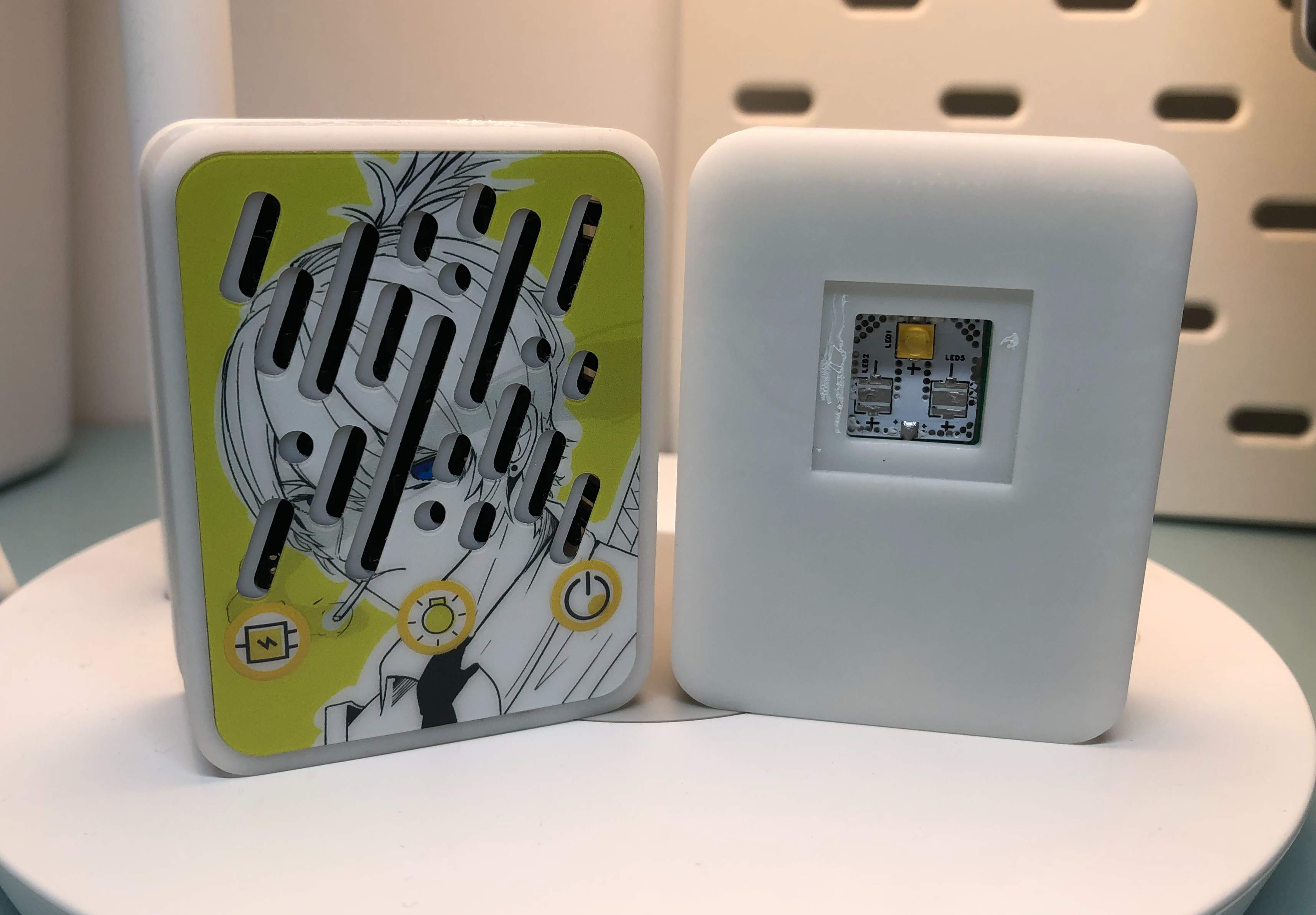

Due to size issues, the design of PCB sandwiched with aluminum substrate was chosen. The light panel uses an aluminum substrate to dissipate heat faster.
Ⅰ.VIEW
#1
PCB thickness is 1.2MM, board size: 40.005mm x 53.626mm. The aluminum substrate is also 1.2MM. In actual testing, one
#2  lamp bead is enough. This circuit cannot support 3-4 lamp beads and will generate heat.
If you want more LEDs, you can replace them with low-power ones.
#3
has two versions: external power supply (type-c female) and battery power supply. Equipped with 1/4 inch screw slots for placing nuts and adapting to tripods and pan/tilts. The back panel of
#4
adopts Lichuang panel PET bulging process, which can also be streaked and replaced with keycaps. The 3D shell is made of 3D Monkey X resin service and can be printed for free. The LED uniformity plate is 1MM thick and can be cut to size manually. You can also use the panel printing service to avoid direct exposure to the eyes.
#5
The heat dissipation method is passive heat dissipation + heat sink (the current PCB heat dissipation temperature is relatively high) will be around 40-50 degrees for a long time, and the heat sink size is 40*40*11MM.
#6
LED driver uses CN5728, supports 2.85V-6V input, and the constant output current can reach 1.5A. Supports multiple lighting modes, simple and easy to use.
#7
Battery and charging versions are available in multiple versions, and you can also modify them for use. Please use a cooling fan for the battery version. The
#8
button adopts 6*6*H13, and the four-corner buttons can also choose 4.5*4.5, as long as the height is sufficient. The screws are M2 and the length is 5mm or more.

CN5728 supports three types of high brightness, low brightness and strobe; Bright light mode.
The flash duration interval can be changed by changing the capacitance value of C1 on the CT pin to change the flash period.

#1
panel choose PET drum bag (the options are as shown in the picture). I used the coupons given through the drum bag test. You can get one for only 5 yuan (the event ends on November 8, 2022).
Under construction The hole location has been deleted due to design issues.
Finished product display
#2
3D shell display
The finished product
is bright for a long time and
low for a long time

The current verification version is the non-battery version, and the battery version circuit has been verified at https://oshwhub.com/23studio/deng-xiang. When using the battery version, please add a cooling fan to avoid unnecessary danger caused by heat.
In the aluminum substrate layer project, four light panels are assembled and need to be cut by yourself. If you only need one type of lamp or if you replace it with other lamp beads, you can only use one. When replacing the lamp bead, please modify the ISET pin resistance according to the formula.
When using a 1.8K-2.1K resistor, high-end heating is above 50 degrees. Choose 2.2K and above, high-end heating below 45. If you want a high-end, always-on light, please choose a resistor above 2.2K.
CN5728 PDF: https://datasheet.lcsc.com/szlcsc/ShangHai-Consonance-Elec-CN5728_C84110.pdf
After a rigorous illumination test, at the same measured distance, the illumination of three lamp beads is only approximately higher than that of one lamp bead. 500lux. Two lamp beads may be the limit of this circuit.
When pasting the heat sink, please use thermal paste or heat sink with a heat dissipation coefficient of 1.0 or above.
Please give me some advice on how to solve the problem of fever.
Other problems will be added.
