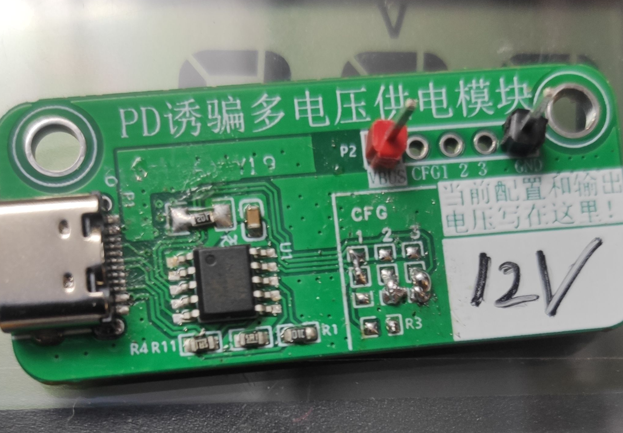

PD deceives multi-voltage power supply module, CH224K realizes common voltage output
! [IMG_20230605_134400.jpg] There is no 0 ohm resistor, use a piece of tin instead.
![IMG_20230605_134418.jpg] Short-circuit according to the configuration, and plan to output 12V voltage
! [IMG_20230605_134242.jpg] Output 12V voltage, but the previous 5V voltage to 12V did not change at one time.
