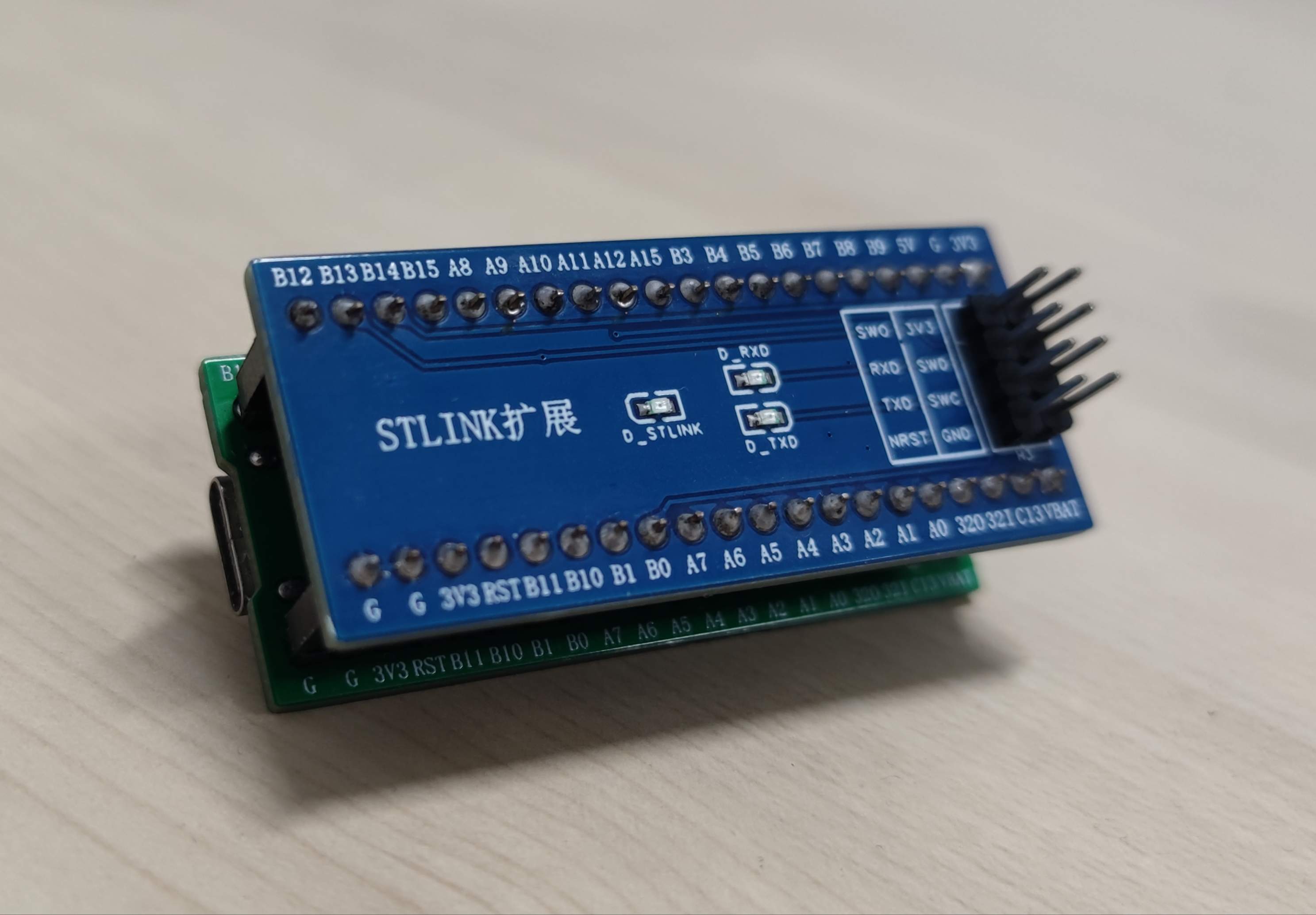

The actual picture of the stlink expansion board double-layer board is as follows.
![1664802604744.jpg]

![image.png] ## 3.5 For the LDO power circuit,
please refer to the manual of this chip. (1117 is used on NANOF1. Why don’t I use 1117? Because my smallest system board is a bit small and the big 1117 takes up too much space)
![image.png]
