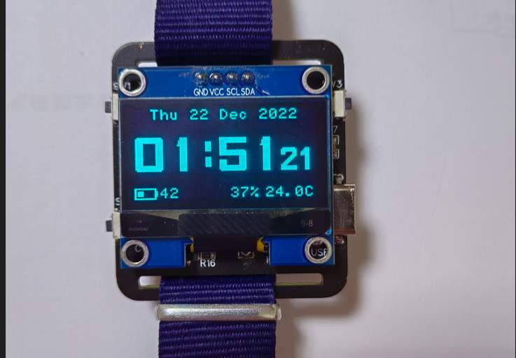

This project refers to the open source project NWatch (GitHub - ZakKemble/NWatch: N|Watch - DIY Digital Wristwatch). The main control uses STM32F103C8T6 to complete the basic functions of the watch, including the DS3231 module to realize clock power-down memory, and the MPU6050 gyroscope to realize watch status monitoring. With the function of turning the wrist to turn on the screen, BME280 realizes the monitoring of air pressure, temperature, and humidity. The SMD5020 buzzer realizes functions such as alarm clock and hourly time reporting. It uses an OLED screen for display, uses lithium battery for power supply, and supports TYPE-C charging.
