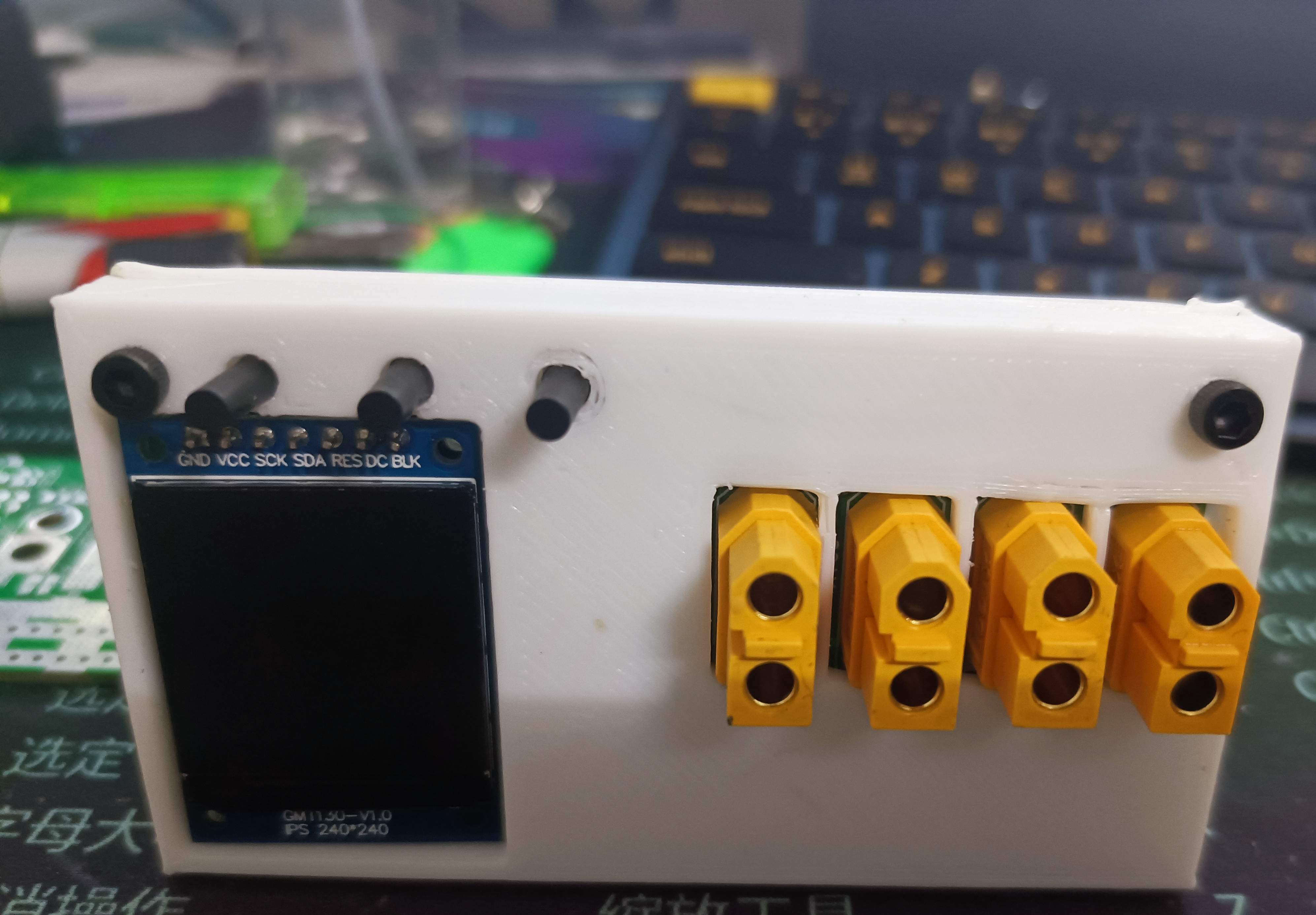

Server power socket
Server power supply monitoring module, single port theoretical maximum 25A, supports CSPS server power supply, the current 460w HP power supply is used.
Because the schematic and PCB have been made public (you can directly build the board and verify that there are no errors), if you want to develop the program yourself, you can use the included program of Code.zip to shorten the development cycle (the code is not well written). I will also release the HEX program file, but to download it you need to use the ICP tool of the AT32 official website, which can be obtained from the official website of Artly, but you need to use AT-Link or J-Link to download (I tried to use the ISP tool to download using serial port 1 but it was unsuccessful. . . Can’t blame me). If you don’t have the tool,
you can join the Q group to find help at 807964977. For components that are difficult to buy, purchase links have been added to the attachments. In order to prevent second-hand dealers, an activation code is required when turning on the phone for the first time. You can send me the number displayed on the screen to get the unlock password. Unlocking operation reference [Making full use of server power supply (๑❛ᴗ❛๑)-Bilibili] https://b23.tv/nQiqLGW
can set the total power of the connected server power supply to match the display (default is 460w) (do not modify it) Yes) (Parameter 1 is the reading interval and can not be changed) (Parameter 2 is the amplification speed of the current sampling chip, ina180A1 is 20 times, A2 is 50 times) (Parameter 3 is the total power of the server power supply) (Parameter 4 is the sampling resistor value) (If you strictly follow the BOM table, you don’t need to change anything except parameter 3 when the power supply is different.)
See the attachment for the 3D shell.
