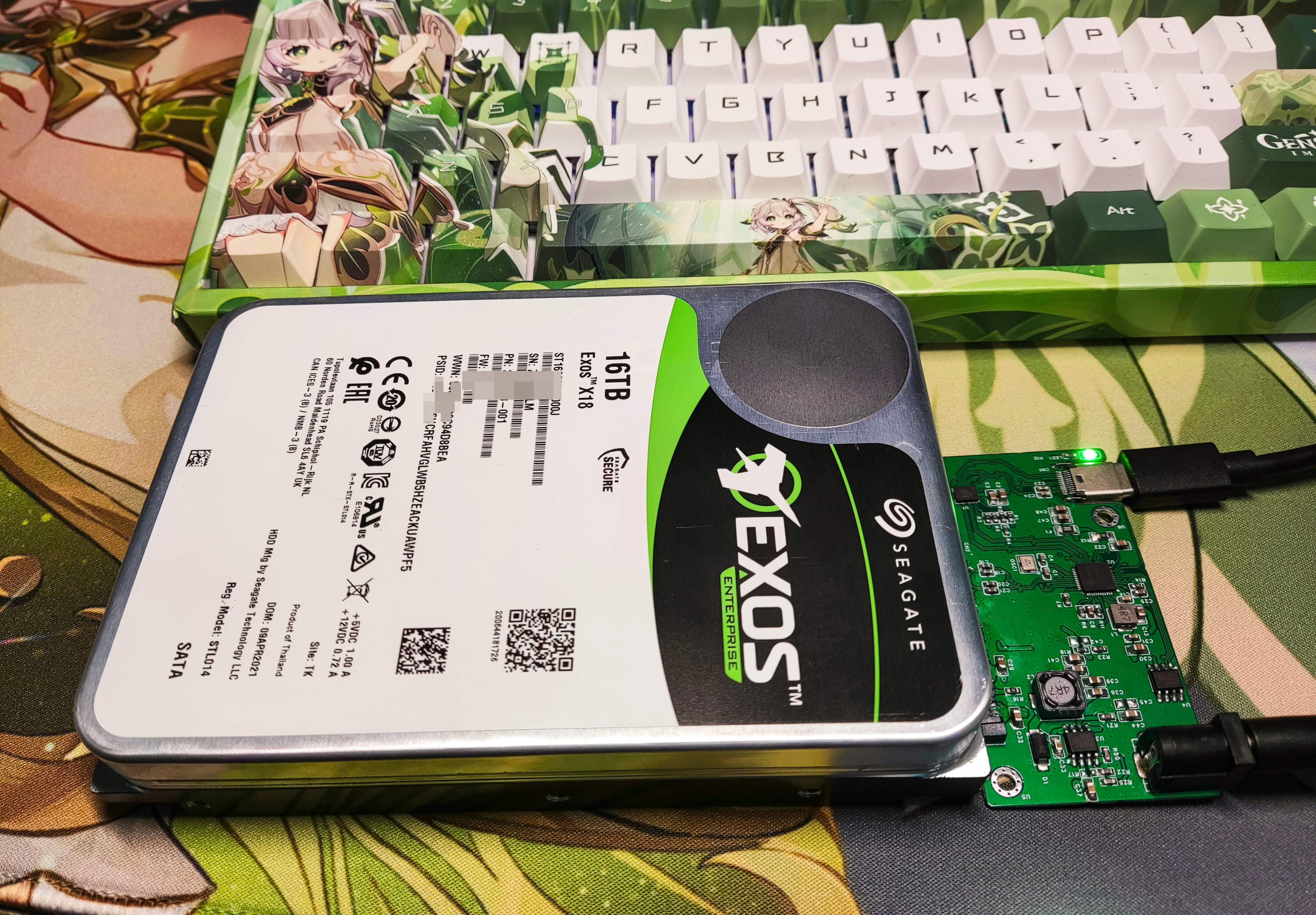

1. Introduction
 JMS578 can convert SATA 6Gb/s (768MB/s) (theoretically) to USB3.1 Gen1, which can be used for SSD, HDD, ODD
VL160 can convert USB3.1 to TYPE-C USB3.1.
With 3.5-inch mechanical hard disk
With 2.5-inch mechanical hard disk
With solid-state hard disk
The power supply uses SCT2650's DCDC, with 12V and 5V path management.
This solution is compatible with solid-state drives, 2.5-inch and 3.5-inch mechanical hard disks, as detailed below.
2. SSD/2.5-inch/3.5-inch mechanical hard disk description
This solution is compatible with solid-state drives, 2.5-inch and 3.5-inch mechanical hard disks.
General solid-state drives and 2.5-inch mechanical hard disks are powered by 5V, and general 3.5-inch mechanical hard disks use 5V+12V dual power supply.
When using a solid-state drive or a 2.5-inch hard drive, you don't need a 12V power supply, only a 5V power supply is needed. Therefore, the following power supply part does not need to be welded. This power supply solution cannot drive a 3.5-inch hard drive without 12V.
As shown below:
The following figure shows that a 2.5-inch mechanical hard drive can be driven without welding the DCDC part of the circuit
. When using a 3.5-inch hard drive, this part of the power supply needs to be welded, and the power supply needs to be powered by a 12V adapter. It is also compatible with the 5V of a 2.5-inch hard drive. When welding,
please note that when using USB5V without welding DCDC, you need to weld 0 ohms or a fuse here
. When using a 12V power supply to weld DCDC, you do not need to weld here, just paste it blank.
Otherwise, the 5V of DCDC may flow back to the USB5V .
In actual personal tests, after welding DCDC, there is no backflow phenomenon when welding 0 ohms 5V here, but it is recommended to disconnect it.

actual speed of different hard disks of different brands was tested
5.1 Seagate Galaxy X18 ST16000NM000J
Brand: Seagate Galaxy X18
Model: ST16000NM000J
Hard disk type: 3.5-inch mechanical hard disk Vertical disk
capacity: 16TB
Cache: 256M
Speed: 7200 rpm
Use: Brand
new disk I just got a brand new disk, so I took this one to operate.
Using this tool, you can initialize the hard disk normally, create new partitions normally, format normally, and modify the volume label normally.
The speed in USB3 mode is OK, and both reading and writing can reach 250MB/s, which is the ceiling of the mechanical hard disk tested so far
