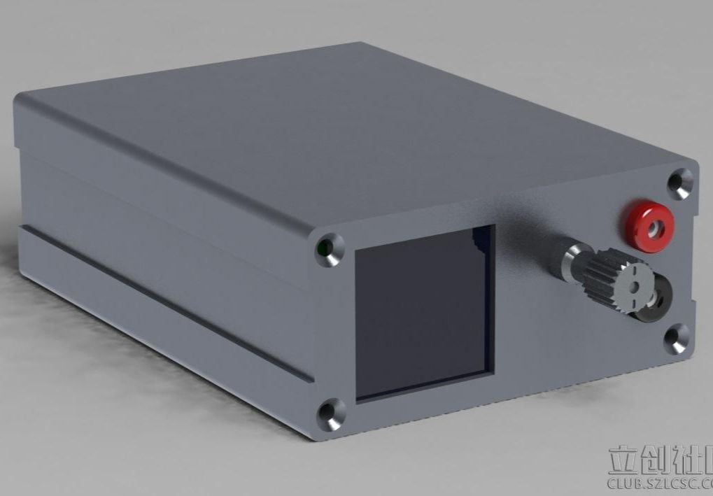

DCP3001
Working range: input AC220V +-10%, output 0...30V adjustable, current 0...0.8A adjustable.
It adopts an isolated flyback switching power supply structure with high efficiency. The primary and secondary sides are isolated
and small in size, about the same It is based on a mobile hard disk and is easy to carry. It
has a built-in user-friendly HMI, LCD display, and encoder adjustment. It
has additional and secondary development functions, such as battery charging, VI adjustable curve output, 4..20mA current source, industrial field signal source and other
main transformers . Parameter calculation:
