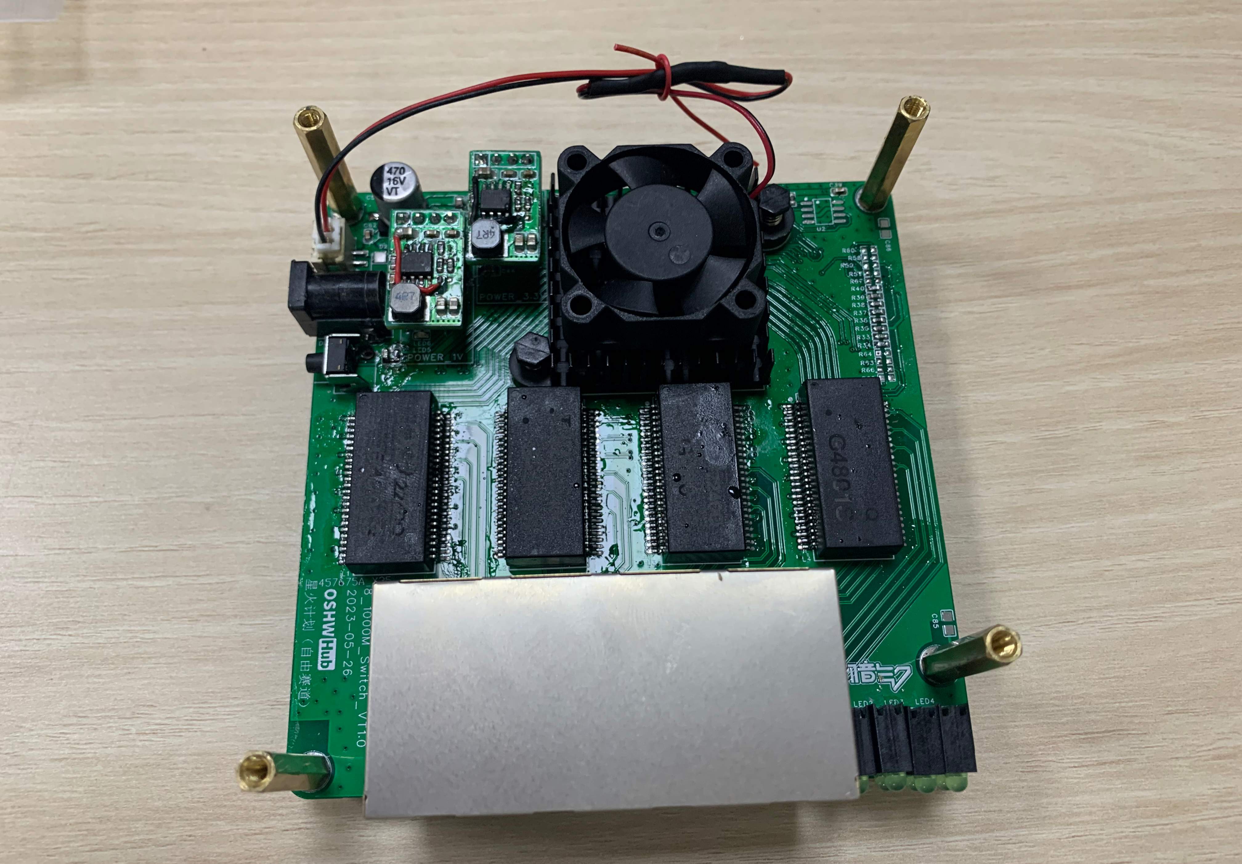

Physical display:
with radiator (cooling fan is optional).
  New version VT1.1 (left). Old version VT1.0 (right).
