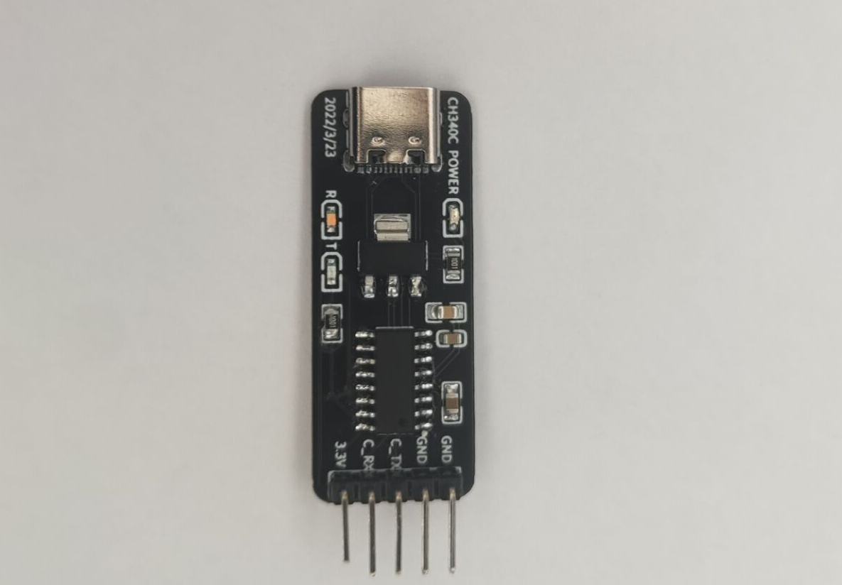

Preface: The first burner I used was one end plugged into the USB port of the computer (as shown below). When using it, you may need a long DuPont line to connect to the microcontroller.
So I drew this board:
You can connect the computer USB port to TYPEC through a data cable, and connect the other end to the burning hole or DuPont line through a pin header to connect the microcontroller to complete the burning.
Actual use (burning diagram):
I lead out two GNDs to facilitate IO0 grounding. Please adjust the lead-out according to your actual needs when using it.
