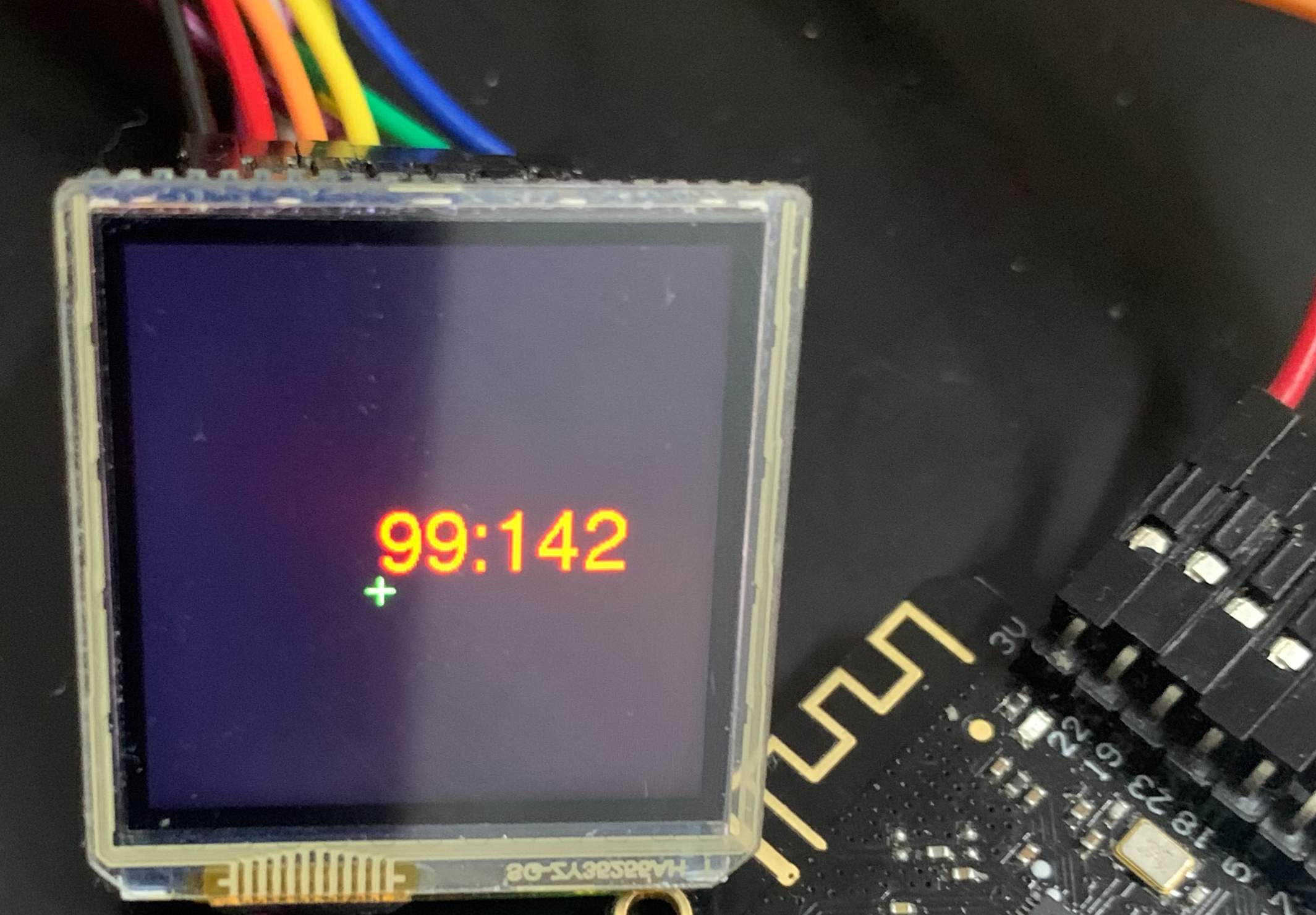

1.3 inch ips touch screen display module
CST813S Touch IICST7789 Display 240x240 SPI
Attachment ESP32 CST813S.zip is the test code
Screen Interface
MOSI 23
SCLK 18
CS 15
DC 17
RST 27
Touch
MOSI 19
SCLK 22
RES 2
IRQ 5
参考设计图片
