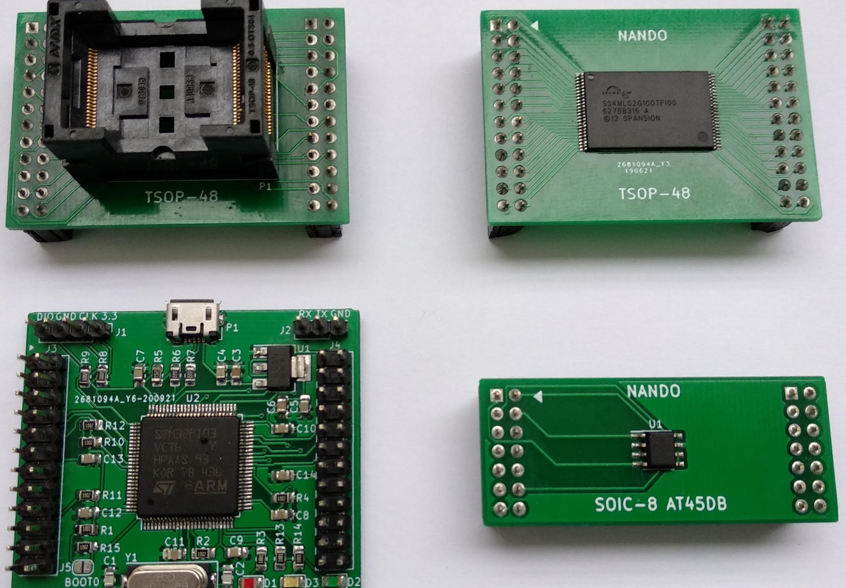

This introduction is an open source project ported from Github: https://github.com/bbogush/nand_programmer. It is an open source NAND programmer based on STM32. I hope more enthusiasts can improve it.
#### Record
- 2022-11-29 The attachment `NANDO_Installer_x64_win10_3.4.2.exe` is a Windows 10 64-bit client, and the PCB version required is 3.4
- 2022-12-08 Due to the epidemic, the PCB just arrived today, and I took the time to put it in The board was welded by hand. It took two hours to solder the board. The main reason was that the 100-pin microcontroller was not easy to assemble and soldered easily.
- The program can be brushed directly according to the steps of the original author, that is, replacing the STM tools with GD tools, it is very simple!
![Main control board] ![Adapter board] ![Correct firmware identification]
#### PCB
![board.jpeg]
