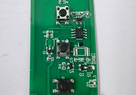

- 20230508 update, me6210 often breaks down, no reason found, LDO replaced with me6216, input only supports 5v
#### Introduction
- 433 remote controller using 17h66 ble chip and Tuya wbr3 module, Supports ble+wifi or pure ble use, the specific project can be configured
- you need to purchase an additional 433 remote control and complete the code
- because it is controlled by the 433 remote control buttons, it supports remote controls controlled by all buttons such as rolling codes. Supports up to 4 buttons

#### Hardware
! [3d.png]
#### Power consumption
- ble+wifi mode: average current is about 60ma
- pure ble mode: average current is about 60ua (not yet optimized)
