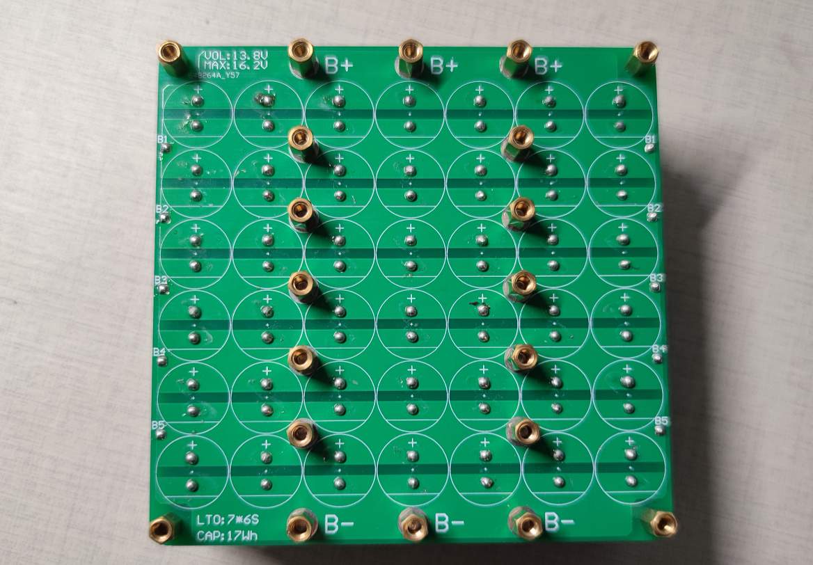

Lithium titanate battery pack 6S7P
Name: 6-series 7-parallel lithium titanate battery substrate PCB size: 100*98mm
Overall size: 100*98*45mm (including bottom plate and protective plate) Parameters: rated voltage 2.3*6, maximum voltage 2.7*6, discharge cut-off voltage 1.9 *6, Design capacity: 14.49Wh
Working conditions: Maximum charging voltage 16.2V 5A, Recommended charging voltage 16V, Rated voltage 13.8V, Discharge cut-off voltage 11.4V, Discharge rate: 10C (10A)

Internal resistance: Overall about 36 -40mΩ (internal resistance meter test)
Actual capacity: 16Wh (5C discharge to 11V)
Note: See the attachment for the AD source file
