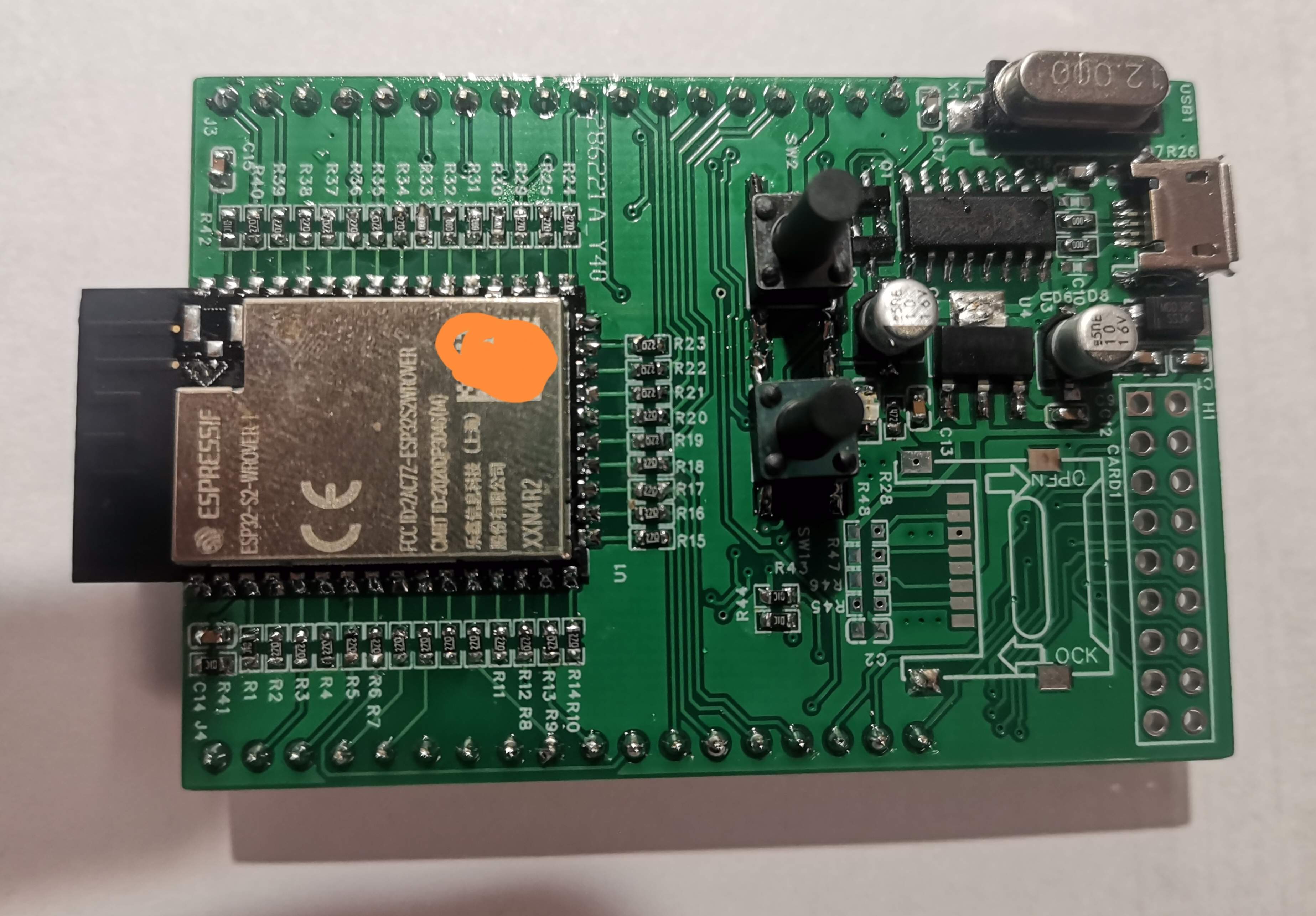

1. Hardware design
      Hardware is the core of system implementation, involving hardware design and ESP32 module program development.
     The hardware part includes the ESP32 module core board, and
     its functions include: ESP32 Module core board, 4G, 5V power supply, lithium battery charging, lithium battery power supply SI network indicator light, etc.
     The hardware part includes ESP32 measurement and control baseboard
       functions including: Ruyikong measurement and control baseboard, optocoupler isolation relay, sensor, LED light, temperature sensor, ADC acquisition potentiometer, etc.

3. Finished product display
The following is a picture of the hardware after welding,
a motherboard picture,
a bottom plate picture,
a schematic diagram, and
a hardware diagram.
