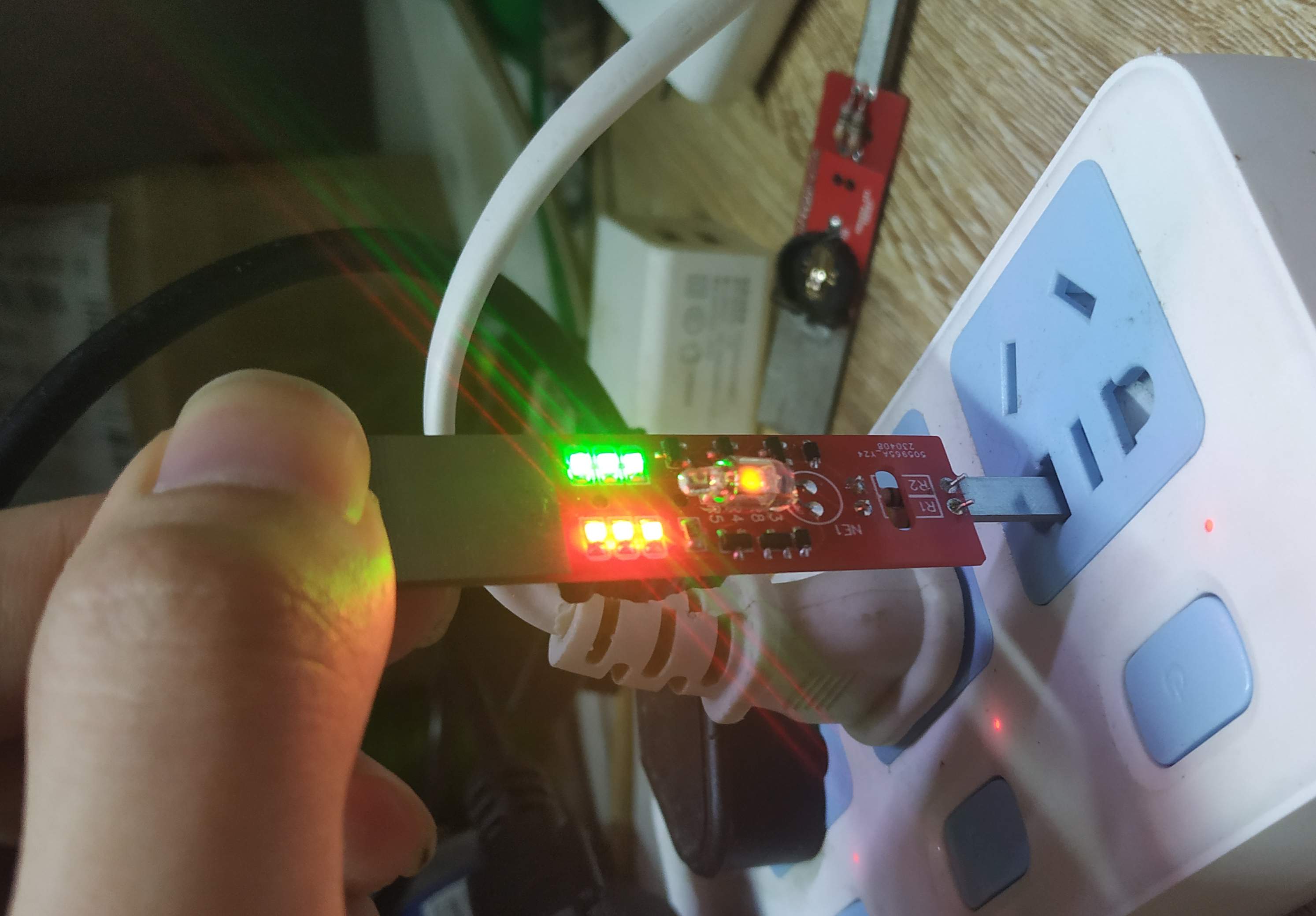

A multi-functional test pen, the complete pen body is composed of the PCB itself and is powered by a CR1220 battery. Measurable voltage range <500V. In fact, this thing has the same function as the "color light meter pen" sold online. I am just imitating it.

The basic function is the same as that of an ordinary electric pen. A person stands on the ground and is connected to the ground. He holds the metal part of the pen tail handle (the wider part, the handle in the picture), and uses the pen tip (the narrower part, the testPin in the picture). ) is in contact with the object to be measured.
Determine the neutral wire and ground wire (grounded object): Hold the metal part of the pen tail and touch the pen tip to the object. Only the green light is on, indicating that the object is grounded (a loop is formed through the earth and the human body). Pictured is the neutral line and a metal table on the ground.
Determine the live wire (charged object): Hold the metal part of the pen tail and touch the pen tip to the object. The neon bulb will light up, the red and green lights will light up, and the green light will be brighter than the neutral line, indicating that the object is charged. If the battery is not installed or the battery is dead, the light will not light up, but the neon bulb will light up and the object can be found to be charged. If you don't want the neon bulb, you can short-circuit the neon bulb's pad to improve the sensitivity of the red light.
