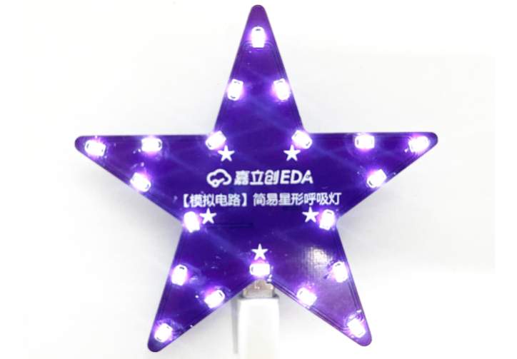

  The simple star-shaped breathing light is composed of LM358 operational amplifier and peripheral circuits, and 20 LEDs are arranged in a five-pointed star pattern.

  When laying out the components, 20 LEDs are arranged and placed in the shape of a five-pointed star, and the remaining components are placed on the back. TYPE-C is placed under the five-pointed star. The layout reference is shown in Figure 5-1.

  After welding is completed, you need to use a multimeter to check whether the power supply and ground are short-circuited, and whether there is a short circuit or open circuit during the welding process. Only after the inspection is correct can the power-on test be carried out. After
      TYPE-C is connected, turn on the toggle switch, the board starts to work, and the LED produces a breathing flashing effect. Adjust the resistance value of the adjustable resistor to change the flashing frequency of the breathing light.
Figure 6-4 Simple star-shaped breathing light working diagram
