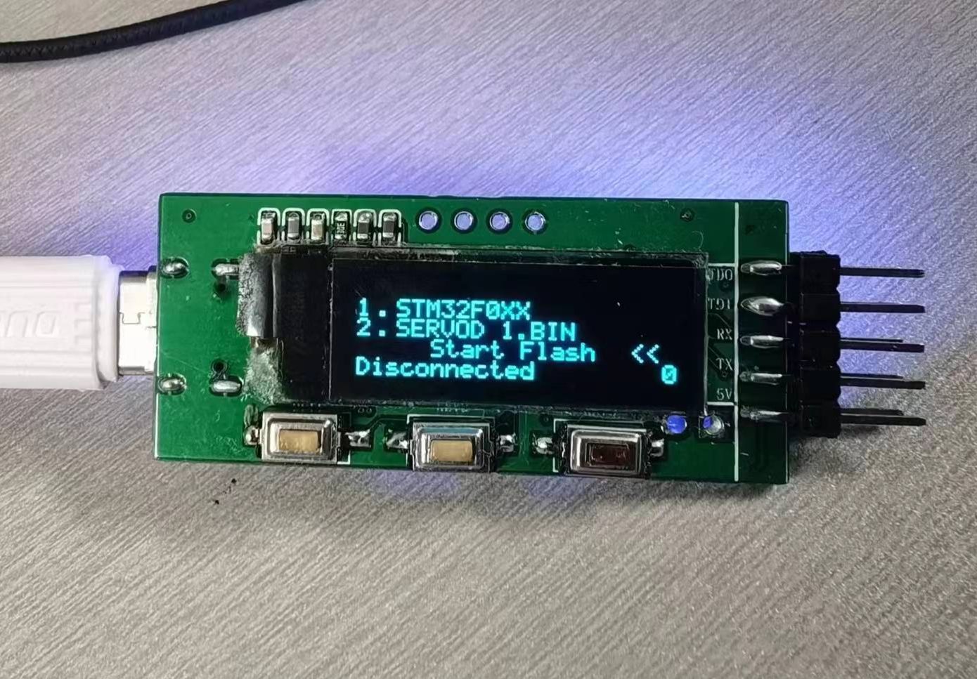

main control chip STM32F103 can directly use AIR32F103CBT6 instead of soldering.
About how to add bin files to the device storage space
(1) Connect the DAPLINK connection to the computer through the Type-C cable
(2) Long press the red button to enter the menu selection and select Online simulation mode
(3) Open my computer, the system will display a drive letter of about 16M
(4) Copy the bin file to the drive, Chinese names are not supported
(5) Long press the red button again and select offline mode
(6 ) Select the target chip and target file through the up and down buttons and the red confirmation button
(7) Select to start writing, click the red confirmation button to write normally
